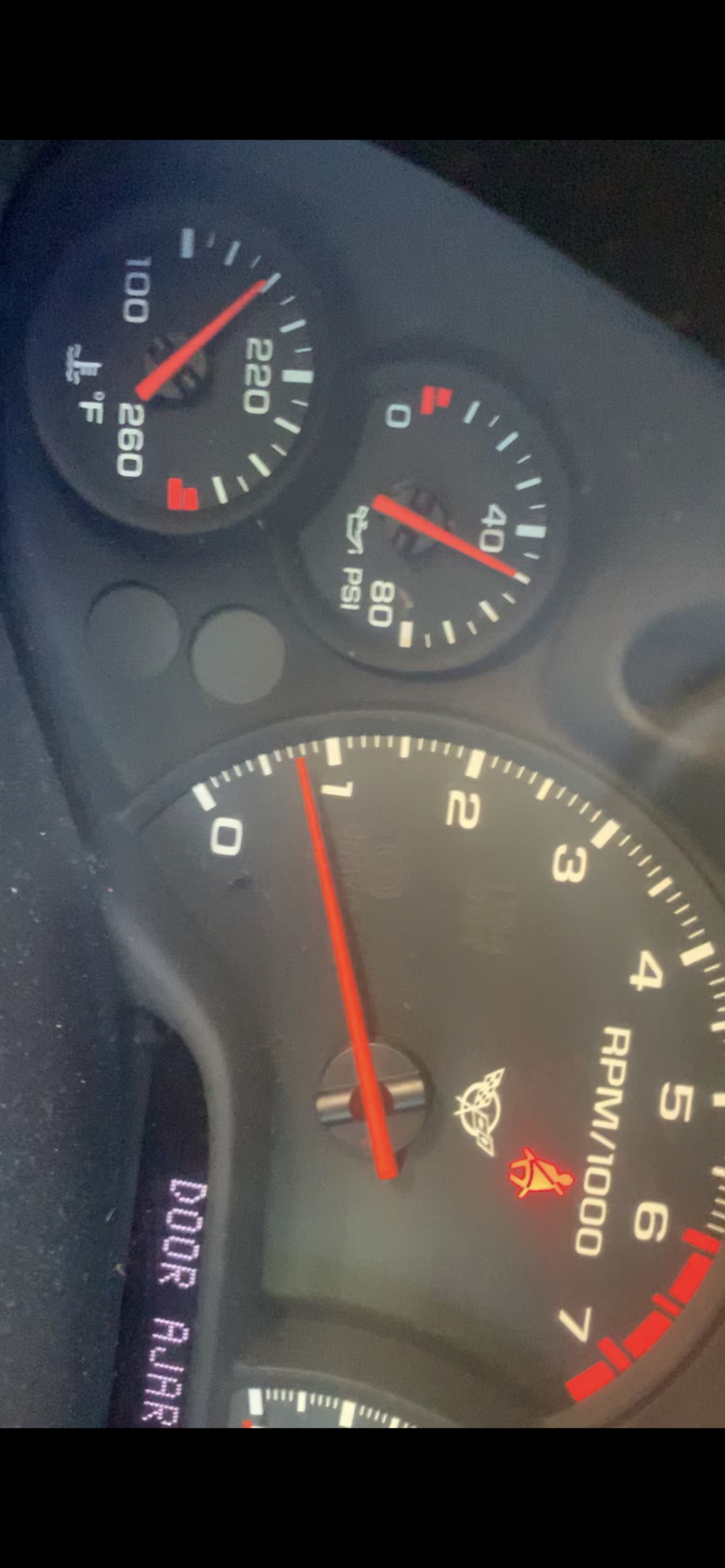

This is a picture I took the same day I took a video which was 3 days ago that’s the oil pressure at idle

Dang that is some hefty oil pressure for a warm car. Mine is around 30 warm idle and around 20 after hard driving with a high pressure oil pump. You should at least have oil coming up through the push rods.

That's what mine is around but when i get on it, miine goes to 80 so that's normal, but what gets me is i dropped a lifter after replacing and put back together i had the same oil from rockers. It was barely any but i didn't have the noise you have. i didn't know if that was normal but i wasn't going to tear it apart agian so i made a decions just drive and what ever happens happens. That was 20k miles. im over 1k hp. Just sharing my story. GL
