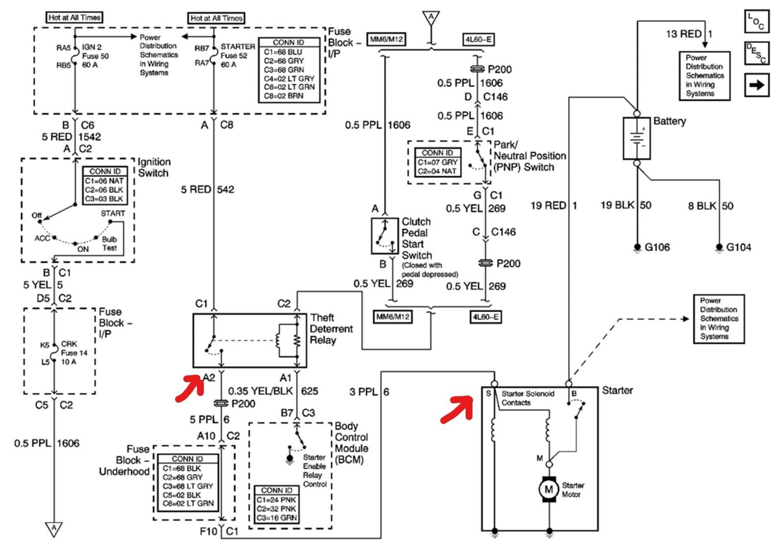

Just helped someone with the same problem, the culprit was a bad TDR, it is located above the BCM in the passenger footwell area, in his case the TDR was clicking when the key was turned to the start position, but the contacts where not sending power to the starter solenoid.

I started troubleshooting this problem about a week ago as mine was VERY intermittent. No crank and only heard relay in passenger foot-well.
It has been doing it off and on for a few years . Usually it would start after a couple of tries so I wasn't hard pressed to resolve it because there were times it would go months without a problem.
Well, it started doing it more frequently so it was time to check it out. Thanks to Bill Curlee, C5 Diag and mmartinez's many posts on this issue. after duplicating it and seeing my security light go out I started at the starter to make sure I had 12V at "B" which I did. I next put a meter on A2 (purple wire) at the theft deterrent relay in the pass. side footwell because it was easier to get to than the starter and used the cig lighter as my ground. When it wouldn't start I still had my 12.7V on the relay which means my clutch pedal switch and the Starter Enable Relay Control on the BCM are ok. So I went down to the starter and had my 12.7V at "S" on the starter solenoid.
Soooo, now I have a starter on order. Hope some of my info also helps.

The TDR is in the passenger footwell near the top. It has 4 wires. 2 of the wires, red and purple are heavier gauge. These are the wires to the contacts. The thinner wires are to the coil in the relay.

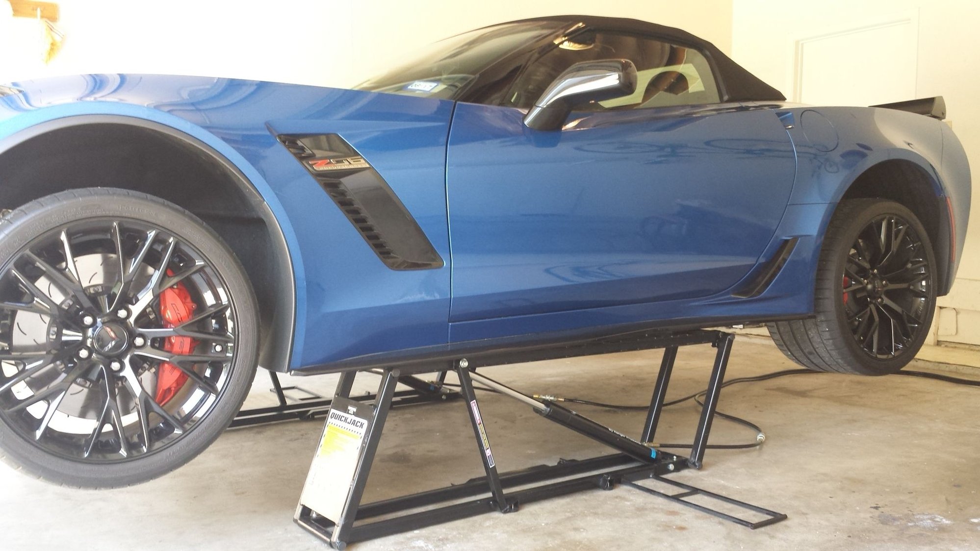

I'm done with jack stands !!...you have to get yourself a Quick Jack if you can afford it !!
To No start issue
