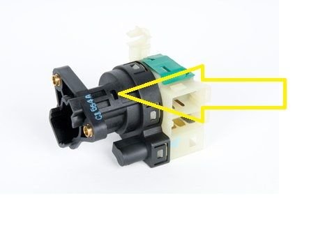

I need to replace the ignition switch in my 2004 CE convertible. I found a great thread by Bill Curlee on how to repair the switch but I have decided to get a new switch. Question is how do you remove the lock cylinder from the old switch and install in new switch?
Any advice will be greatly appreciated.

there is a button you push and the cyl. comes out !!!
site won't load pic ????

think the key should be in on position ??

Thanks Pounder! I knew the Forum would come through

Yea it’s one of those things that when you have it apart makes more sense. I did mine in a few minutes, I was surprised at how easy it was!

Yep cylinder has to be in ON position for it to come out and go in.
Also found out after a lot of struggle it has to be in ON position to get shifter cable out and back in..
If I ever need to change one again it will be a breeze.
