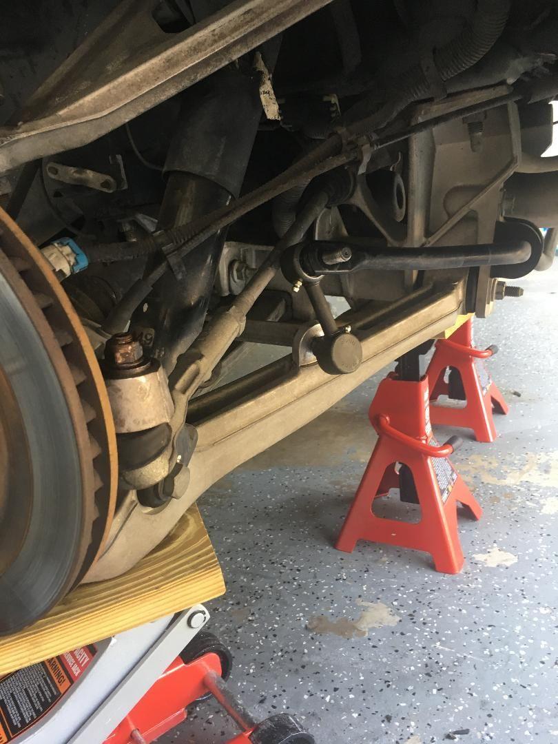

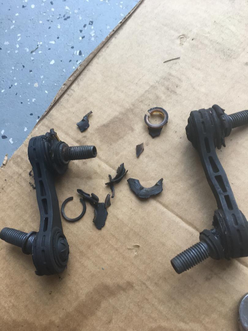

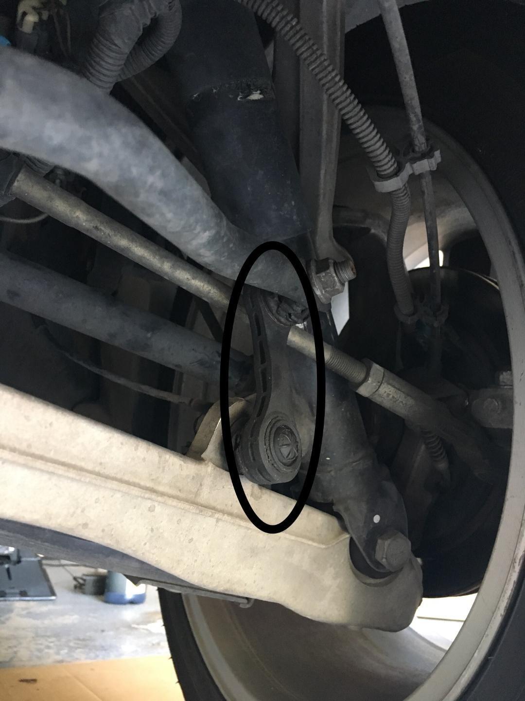

And is it hard to replace? Was changing my manual transmission and engine oil and while lifted, noticed the deteriorating bushings. 1998 68K miles.

plastic end link, junk, I replaced mine with Moog with grease zerks !!!

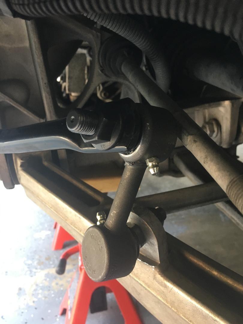

Default Job done
That was one of the easiest things I've had to do... 2 hours did the rear. Just ordered 2 more for the front.

Sway bar end links... easy to swap. As mentioned get the Moogs.
