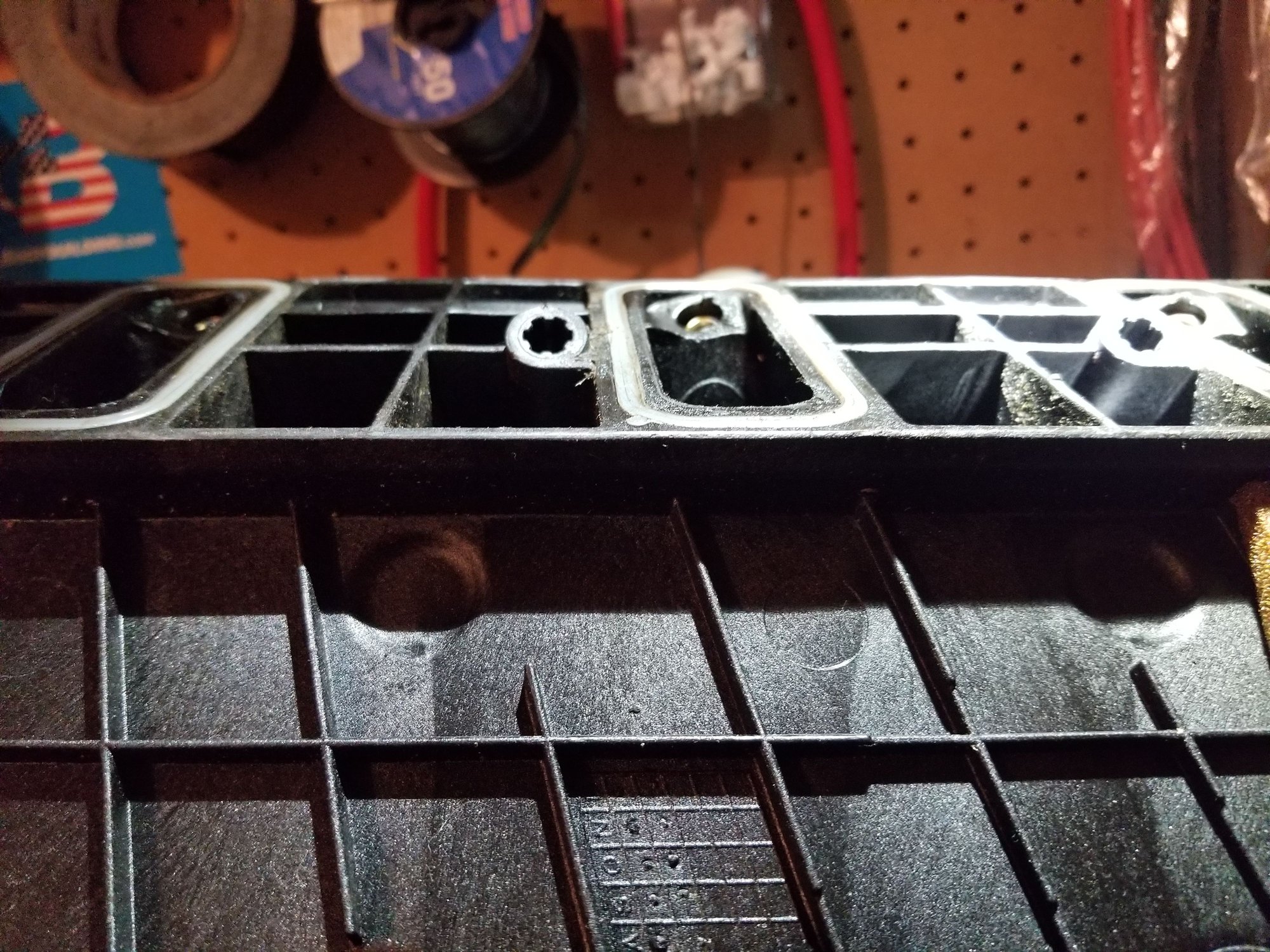

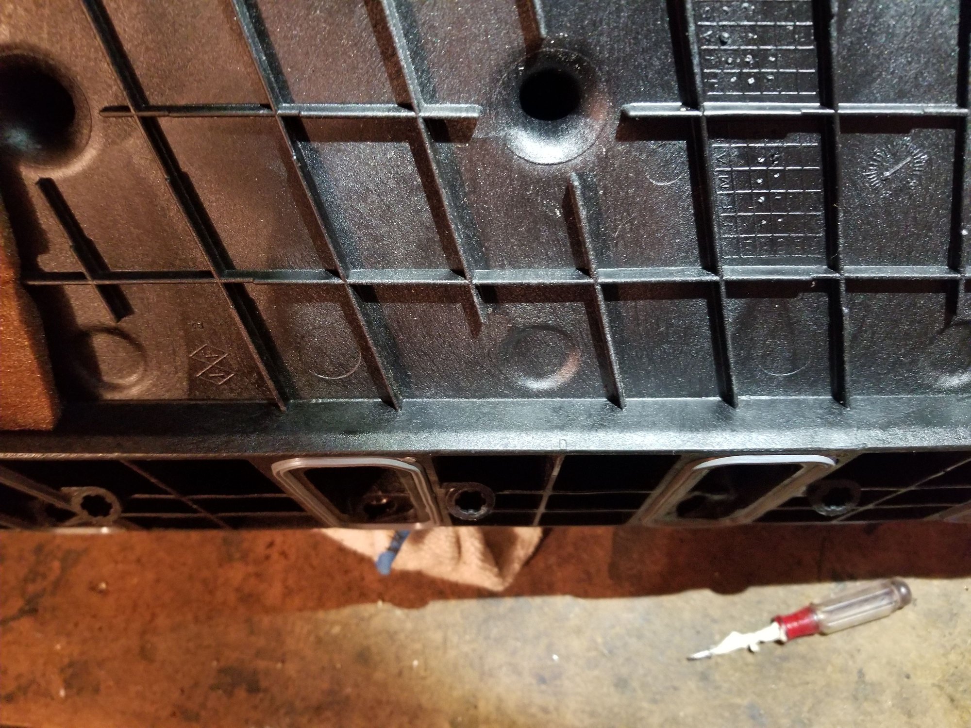

Well i have been chasing misfires and nutty fuel trims..no codes. So i pulled my intake and i found this gaskets on all the ports were gone..the intake to the head was the seal..and here is after the new gaskets! Idel is smooth car now has power it was running rich..
