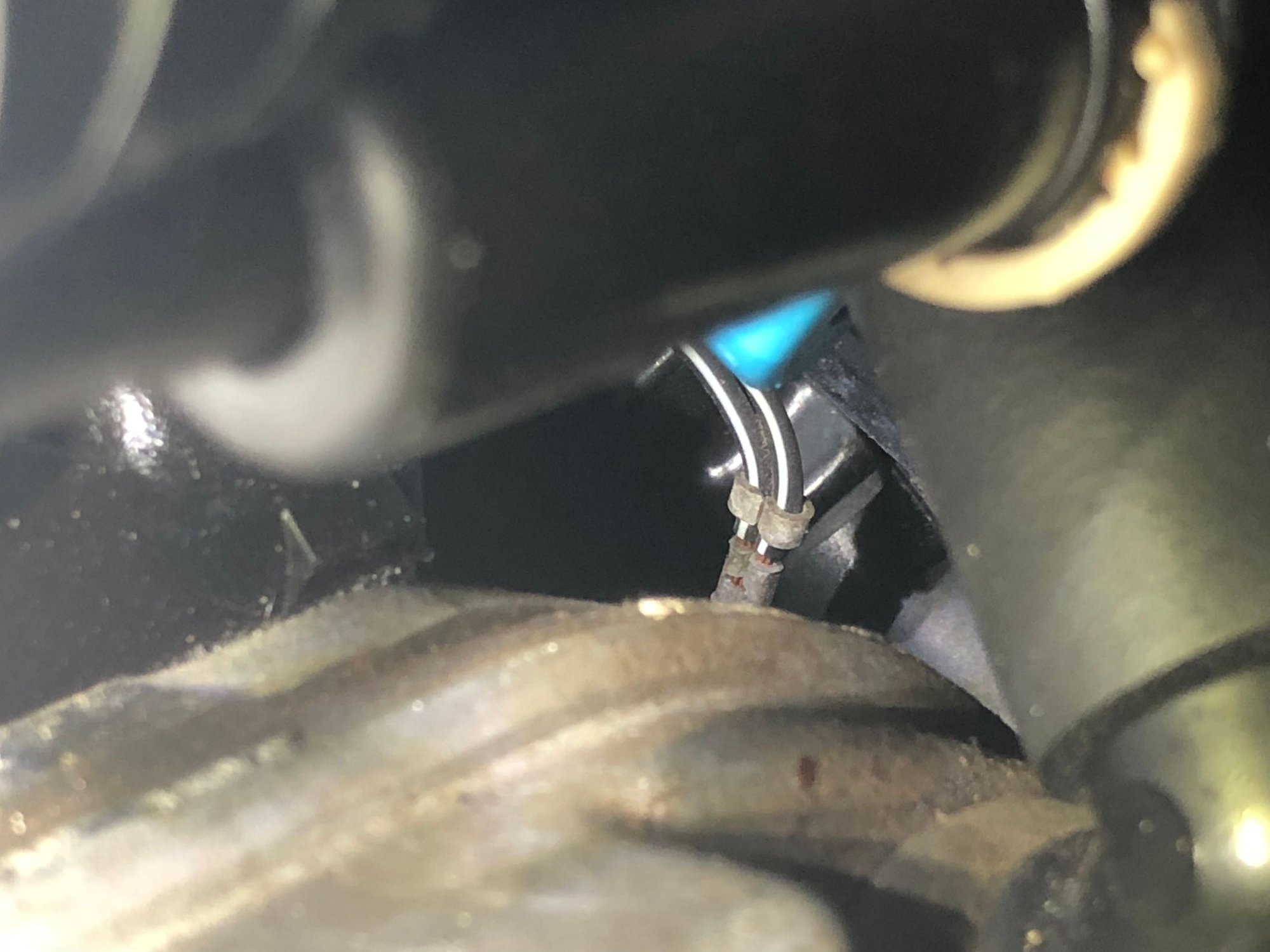

Sounds like one bank is not firing. The ground for the coils is at the back of the drivers side head. If you get a light and look back there you should see the ground lug and wires. There are two wires on the ground lug. You can take the ground off without removing the intake.

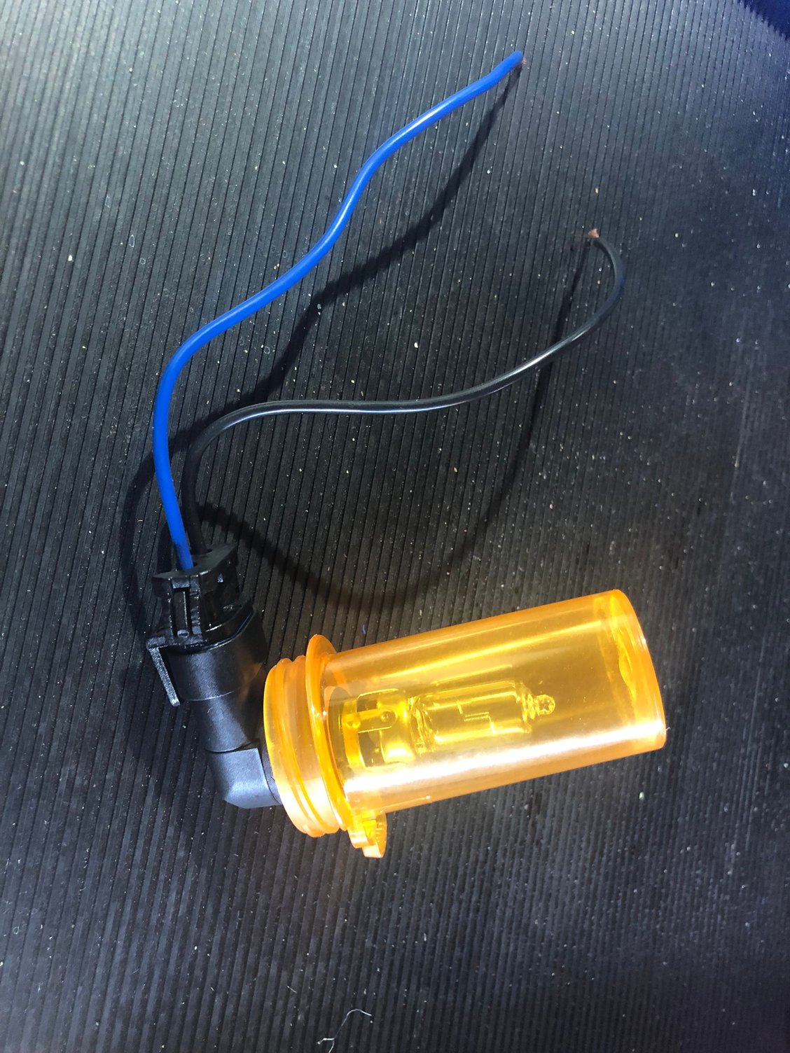

Welcome and the ground for each bank of coil packs go to G107 which is at the back of the left cylinder head (pictured)...not easy to get to or even see for that matter...how did you determine that the ground was bad ??... if you used an ohm meter that is NOT the best way to test...get yourself an old headlight with both wires attached (pictured) and run the positive wire to battery positive and the negative to the ground you are testing...the light should be bright if the ground is good...you can make yourself a jumper wire by back probing the black/white wire at the connector between coil packs 4 and 6 and attach the other jumper wire to a good ground...see if the misfires go away...you may have a broken wire somewhere between the connector and G107 !!

Thanks for the help! I checked the ground on the back on the engine. Mine looks just like yours and I was able to get my test light on it and had a good ground (at least to the metal terminal). I can't really get a much better look than you did with your picture and I'm not sure I would be able to get it off with the air intake on to look at the condition of both wires.

Are you using a Power Probe ??...to test grounds you really have to “load” the circuit !!...like I had mentioned using these headlight bulbs is the way to go and not using an ohm meter !!...you may have to start unwrapping the electrical tape and see where you problem lies !!...this pic is loading the coil ground !!
