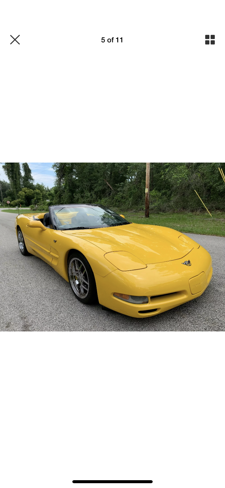

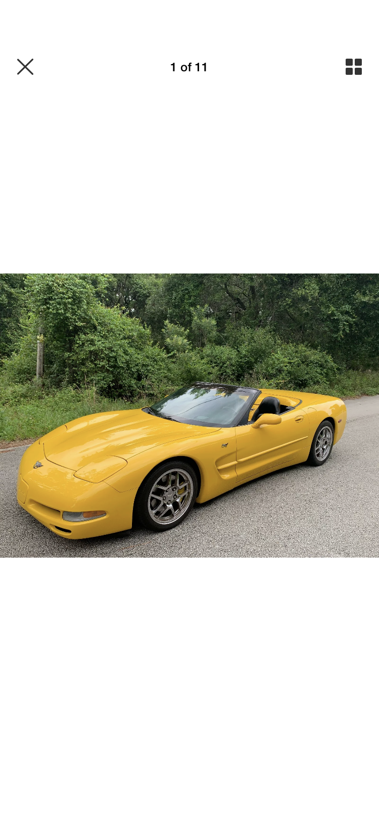

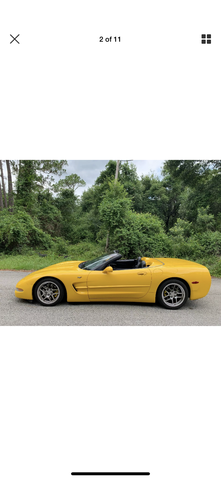

And we need pics of said vehicle, please!
