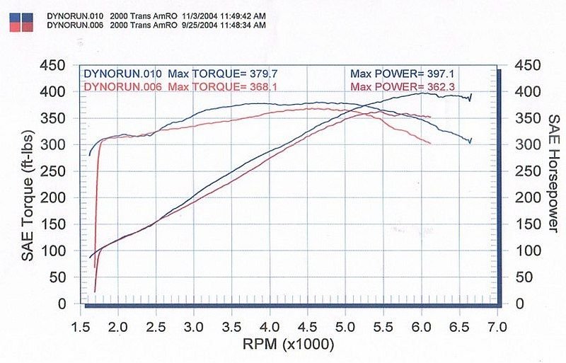

Yes, I'm thinking of a cam somewhat similar to this or, 224/114. Reason being, I'm worried about not getting additional torque from the lower end of the RPM Range...
This is a graph from LG, depicting one of the most important upgrades...their Long Tube Headers, plus minor boltons. Because, maximization of the efficiency of the Motor, prior to additional Modifications...
As you can see...there is noticeable improvement in TQ, after certain amount of RPM's. This is the nature of our LS6, that I'm trying to avoid.

I suppose Bill is preoccupied. Therefore I'll expand, on cam correlation.
Here we have Evidence that a larger cam, in this case TR230, doesn't lose any low-end power, however gains through our midrange, and up top:
Yet, it does NOT gain at lower RPM, like this baby cam @ 212/218:
Subsequently, this is most definitely a trade-off!
The smaller your Cam, the more off-idle and lower RPM torque...
Thus...what is preferable for Autocross? For the street? What is an acceptable power-on RPM? Why can you not have the best of both worlds? Is this why custom cams, from for example EDC @ Flowtech, is the Best?? All valid questions.
