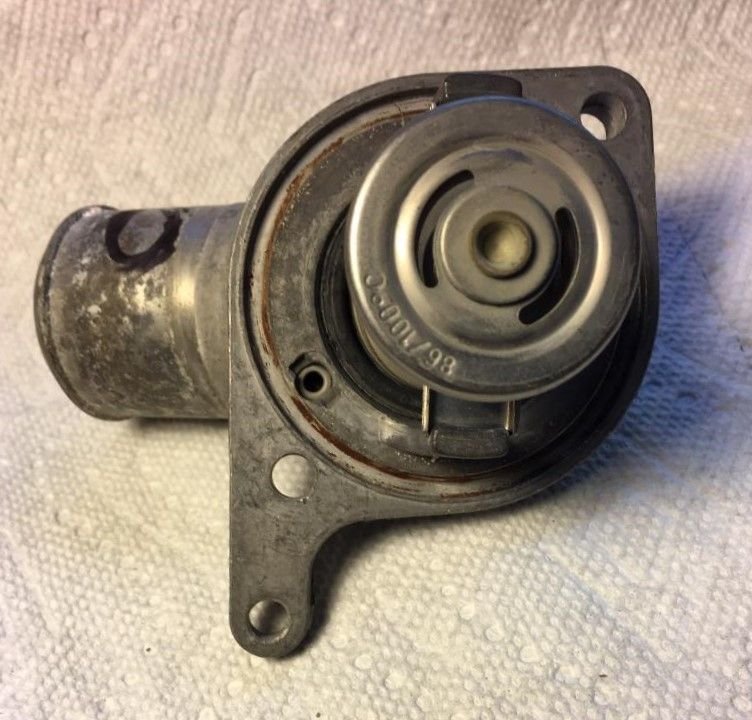

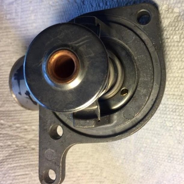

Well, it is still a mystery, here are some things to think about. I think up through 2001 the thermostat and housing were integrated. 2002 and later the housing is separate from the thermostat. Here are pictures of two integrated units I have run without issue, first an AC Delco OEM, second an aftermarket.
Note that the OEM has a bleed hole at about 8:00 in the housing AND has circulation holes in the disk that seals the flow.
The aftermarket has a bleed hole in the thermostat disk at about 4:00, no circulation holes in the sealing disk.
Probably should give a careful look at the thermostats you are using as well as the housing(s). Maybe a mix between aftermarket and OEM is stopping the bleed which occurs as you fill the system with coolant.

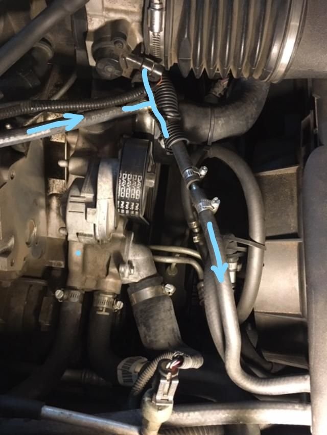

Another possibility is a block or partial block in the coolant air bleed system from the heads. A car that has had old coolant in it can have sludge which can impair flow through the small coolant air bleed lines and leave air in the heads. 2001 and later LS1s have the rear coolant air bleed ports blocked and not connected which can make the situation worse. Many of us 2001 and later LS1 guys have reconnected the rear ports on the heads to the front coolant air bleed line for better assurance of getting air out. Not sure about LS6 heads or your installation. The LS6 manifold does not have enough room under it to allow the 2000 and earlier air bleed line from the rear ports to go under it without modification.
Instead of the FSM air bleed method of 3000 RPM etc. I use a very positive air bleed method whenever I open the cooling system on my car. The following picture shows the coolant air bleed line from the rear head ports Teeing into the front line after the throttle body. Note the connector about mid right on the way to the radiator. I disconnect there, block the tube going to the radiator and bleed directly to a container on the floor under cooling system pressure. It has taken as much as a quart of coolant flowing out before air bubbles stopped.
