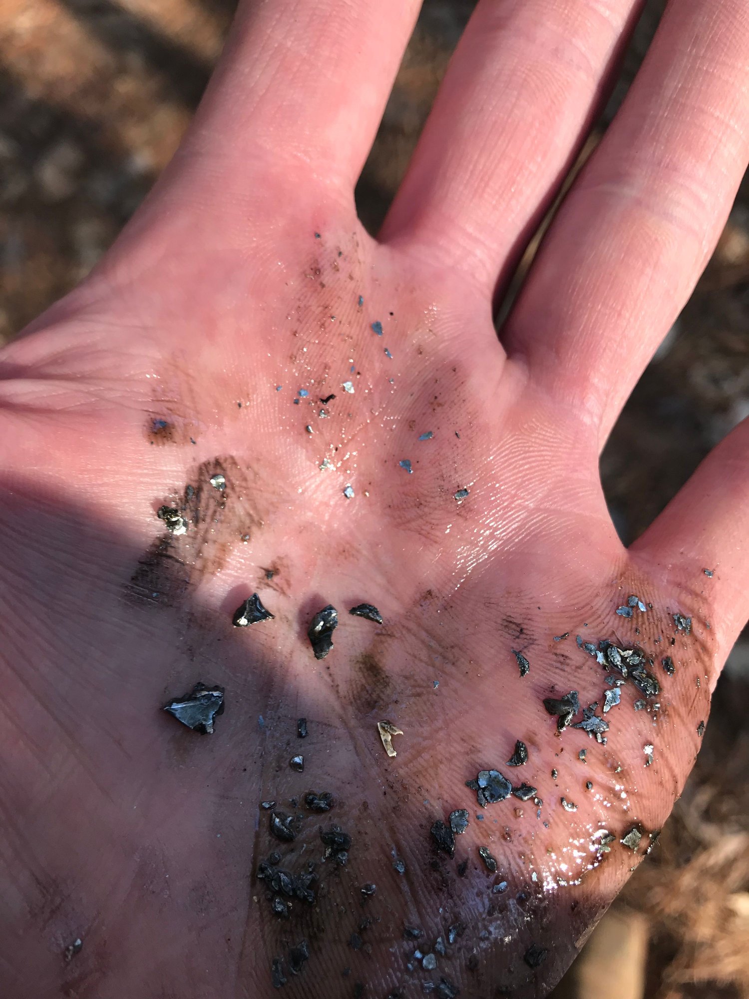

Yeah Bill, I read all your posts about upgrading our rear diffs with c6 parts. I checked for broken Belleville washers, jacked up 1 rear tire and left other side on the ground, I could literally roll the lifted tire with very little resistance at all. It was the same on both sides. So I know the Belleville washers are totally shot. The odd thing is if I dump the clutch at 4000 rpm’s it’ll leave 2 solid black marks till I get out of it. The only symptoms it has is a steady whine under throttle, that increases with speed. And a bunch of metal came out of it when I changed the oil in it.
Just a little bit of metal
To Rear diff decisions
