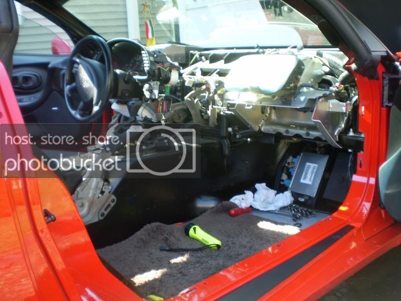

Phil, it sounds like your BCM and fuse panel in the passenger side foot well has gotten wet. It was one of the first issues I encountered with my C5 when I purchased it in 2004. The udders get blocked and water (condensation) backs up in the evaporator above the passenger side foot well. Water over flows and drips/runs through the blower motor into the passenger foot well where it gets the BCM wet. A wet BCM will give you all of the extraneous indications you saw and even more.
Pull out the passenger side mat and you will see a panel that runs up the firewall from the base of the foot well. Remove the panel and you will see the BCM and the interior fuse panel. Look for signs of water intrusion. You will likely find water and a wet BCM. If you find evidence of water you will need to dry the BCM (and the foot well area), carefully. Bill Curlee has posted some great instructions on just how to do this. If your carpet and padding is seriously wet, you may however elect to remove them to dry everything out.
Here's a good picture of what you'll be looking at. You do not need to go to any where this extreme removing the seat and carpeting, but for illustration purposes, the BCM is the shiny box with the writing on it in the lower right corner of the foot well.
You will need to address the plugged udders of course to ensure the problem doesn't reoccur.
