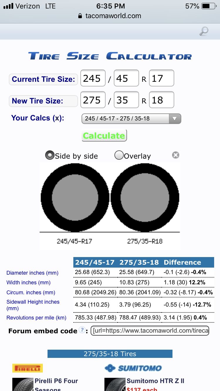

What is your specific rim/tire sizes front and back? My first thought is the stagger ratio front to back isn’t quite right which will make AH/TCS to act up.

Tire Size:
Front: 245/45 ZR 17
Rear: 275/35 ZR 18
It does drive good when I turn it OFF, just wondering if I should do anything to fix it?

I believe your tires are the issue. The rears appear to be shorter then the fronts based on the sizes you provided. Rule of thumb is that the rears should be 1/2-1” larger in diameter then the fronts

Your EBTCM must be less sensitive than the one in my 97. That would shut down forward motion of the car with the rear tire being that much smaller than the front tire. With the engine idling and TC turned on It would stop the car from coasting down hill with the transmission in neutral and the clutch disengaged. The stock rear tire is 275/40/18.
