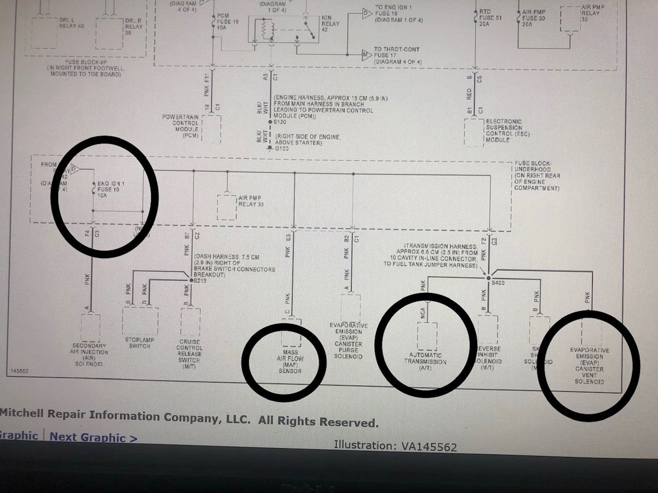

two of the 7 codes I dont care about PO102 (02 sensor) (dont care about) P0443 (Evaporative Emission (EVAP) Purge Solenoid Control Circuit) (dont care about) P0740 (TCC Enable Solenoid Circuit Electrical) P0753 (Shift Solenoid Circuit Electrical) P0758 (Shift Solenoid Circuit Electrical) P1860 (TCC PWM Solenoid Circuit Electrical) C1241 (Magna Steer Circuit Malfunction) any insight would be helpful

Welcome to the Forum !!...FIRST thing please include the year of your car with all mods either here or in your profile...there are differences year to year !!...you have a LOT of "electrical circuit" DTC's...check the ECM Ign1 fuse # 19 !!...as you can see all these DTC's are tied in electrically and a P0102 is a MAF sensor DTC not an O2 sensor and I think I circled the vent instead of the purge solenoid by mistake.
