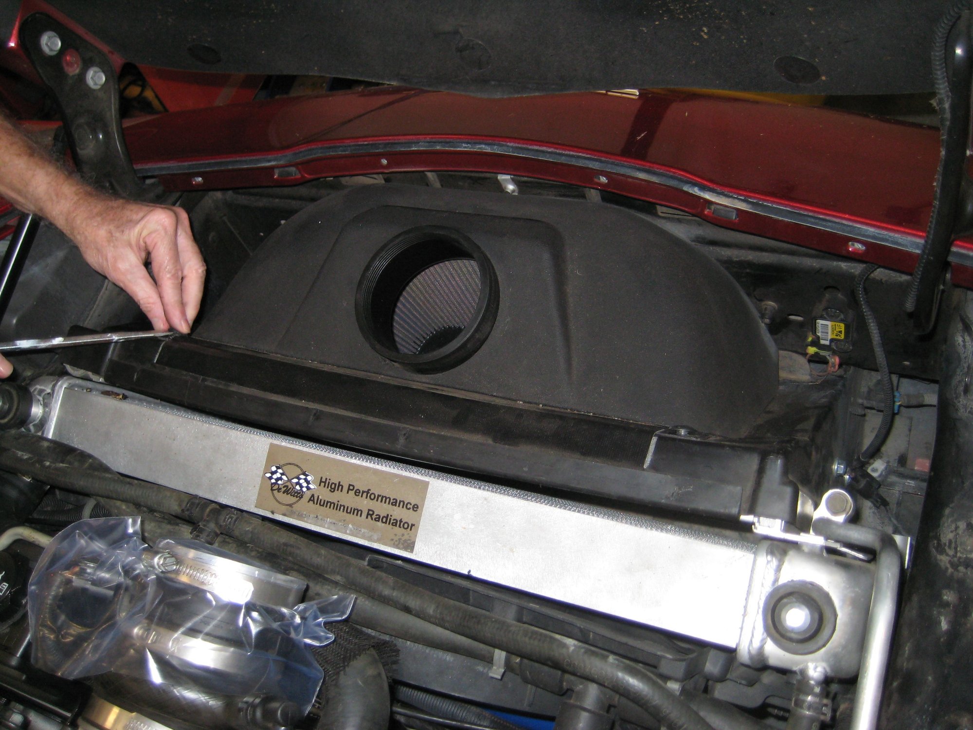

We had a friend bring his early C6 track car to my garage because it would overheat when running on the track. The engine was a Lingenelter stroker lots of HP so lots of heat to shed. The car had a history of overheating from the previous owners, so we kinda feared the worst. We checked the coolant side with water soluble flourescing dye and that side of the system was tight, no leaks. Then, since it is a bottom feeder like a C5, looking underneath a PO had put a big oil cooler right in the bottom feed path. We thought that was the problem; not so. To make a short story long the car had a Dewitt's so all things right, should and does have the capacity for this engine.
We took the Dewitts out so we could access the AC condenser from the back and there was this brown sticky goo all over the condenser. All the rubber *****, seeds dead bugs and squirrel hair were stuck to this brown goo. Turns our the culprit was that beautiful Lingenfelter CAI and an oil catch can that could not keep up with the blow-by and the top end oil. So, any time there wasn't a big engine vacuum on the system a little oil would burp into the air filter and eventually was deposited on the condenser.
We completely solved his cooling problems by removing the CAI, covering the hole cut in the radiator shroud, and replacing the OEM air filter system. Oh yea, we used FROST KING air conditioner coil cleaner and a garden hose on both the condenser and the rad. After that, he could run the pee out of the car and it stayed in an acceptable temp range. Since there is no path to get the goo back on the condenser, the catch can can wait a bit. That's another story. However, the takeaway is that the CAI's that everybody thinks so highly of can be a problem. When that radiator shroud is cut on a bottom feeder, then the CAI will compete with the radiator for the available air. This is the third car we pulled the CAI off and replaced with OEM. The the cars actually ran better.
