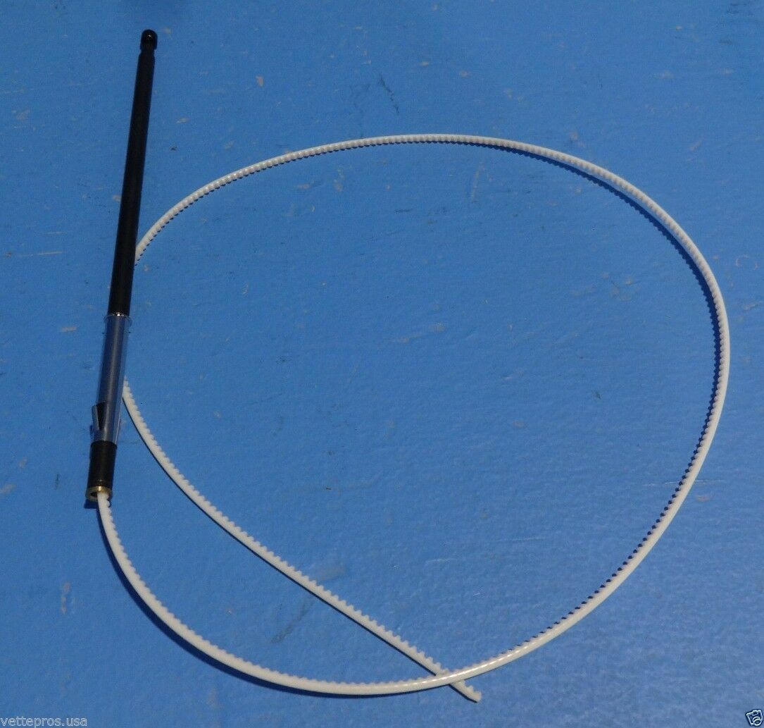

My antenna will not go all the way down............stops about 3 to4 inchs every time I shut the car off........any help?? thanks in advance

The teeth on the mast are probably worn out. I replaced mine, cost about 15 bucks and followed these instructions, Took 10 minutes.

The manual does not recommend lubing the shaft. It attracts dirt. It is recommended to keep it clean and dry. I had the same problem as the OP. Tried lubing the mast, but the teeth were worn out. A new mast fixed the problem, cost 12 bucks and has lasted 5 years now.

Just bought one on eBay after breaking the factory mast off last weekend. Search for "C5 replacement antenna mast" - total cost was around $25 shipped.

Yeap I installed that one too. The shorty antenna was too short and hardly pickup any radio signal. Got a 18 worked a little better. Might try and find a little longer one. My power antenna mast has been replaced 4 times. Everytime a piece break off inside and I have to take the whole power assembly out and a part to fix it. No more. Last time it did not go down someone made it into a pretzel,

You can - I did. You just need to buy a Z06 mount from a yard. The power antenna really dated the car. The shorty is a very high quality from antennamastsrus. Also, in the past when i have replaced power antennas and ribbons, they were the best source. Replacing power masts is easy - even if the ribbon is broken off inside.

Installed the new power antenna mast in less than 5 minutes and works perfectly. I did end up buying one from The Antenna Source (also called AntennaMastsRUs) and returned the one I got on eBay, as I wanted one with a black tip to match the OEM antenna. https://www.theantennasource.com/CHE...98-2004.html#1
