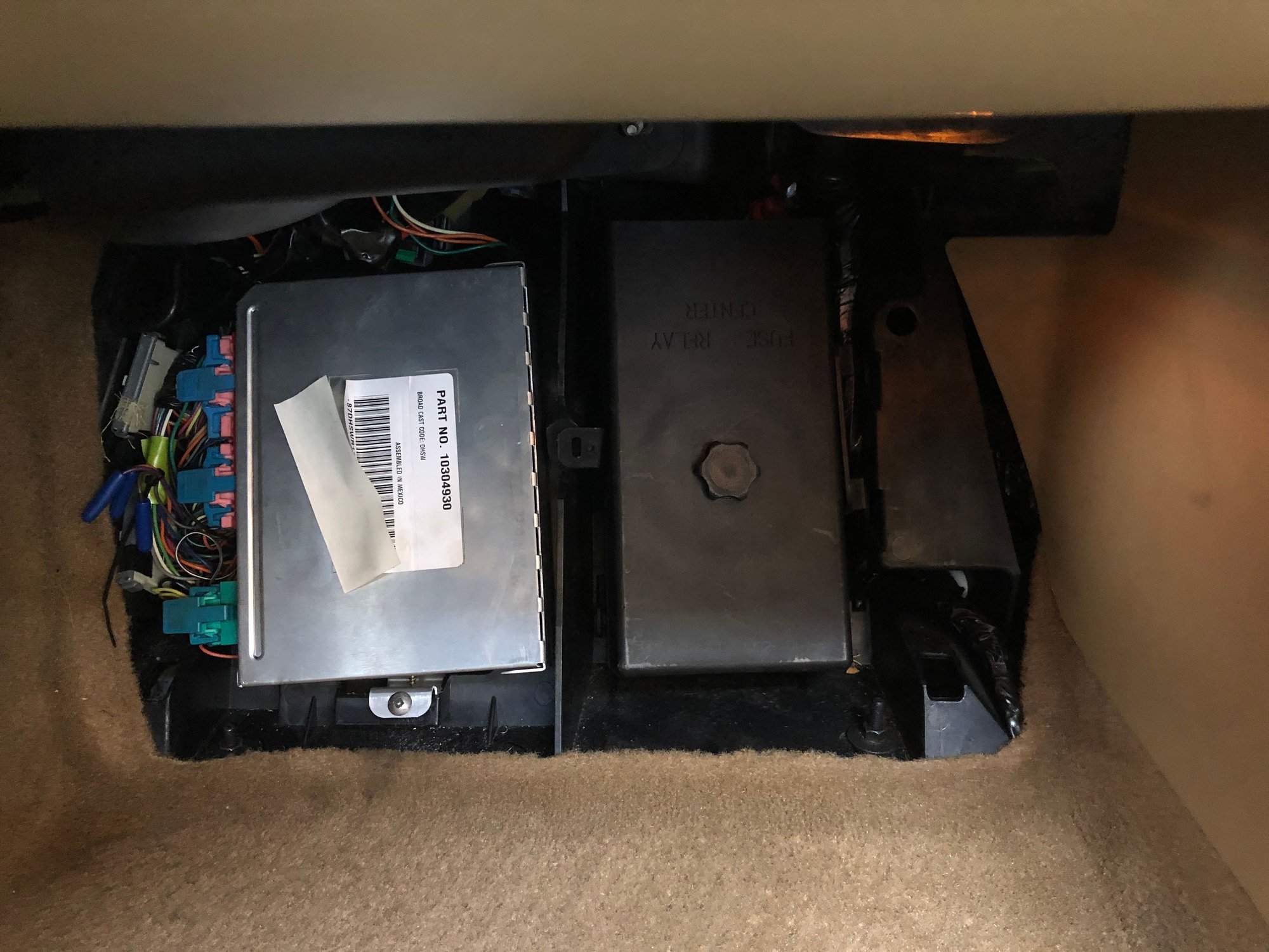

My C5 battery keeps draining and I have jumped it a couple of times, I hear a buzzing noise on the passenger side floor board.
This is where I’m hearing the noise

That box there is the BCM..is that where you hear the buzzing ??...are you planning to take it to a repair shop ??...I'd recharge the battery...remove those 3 connectors...and let the car sit a few days and then plug in the connectors and see if it starts...also it is a good idea to let us know what year the car is and mods it car has...this "helps us help you"...you can post this info in your member profile...there are variances in wiring and components year to year !!

Yes that’s where I’m hearing the noise and not going to take to shop just yet want to see what I can do first, and it’s an 2000 coupe, I will recharge the battery and disconnect the wires for a few days, thank you.

Now it could be a component that goes to the BCM and that would have to be addressed and some electrical testing will be required !!
