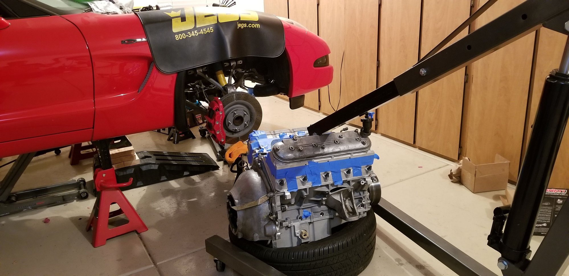

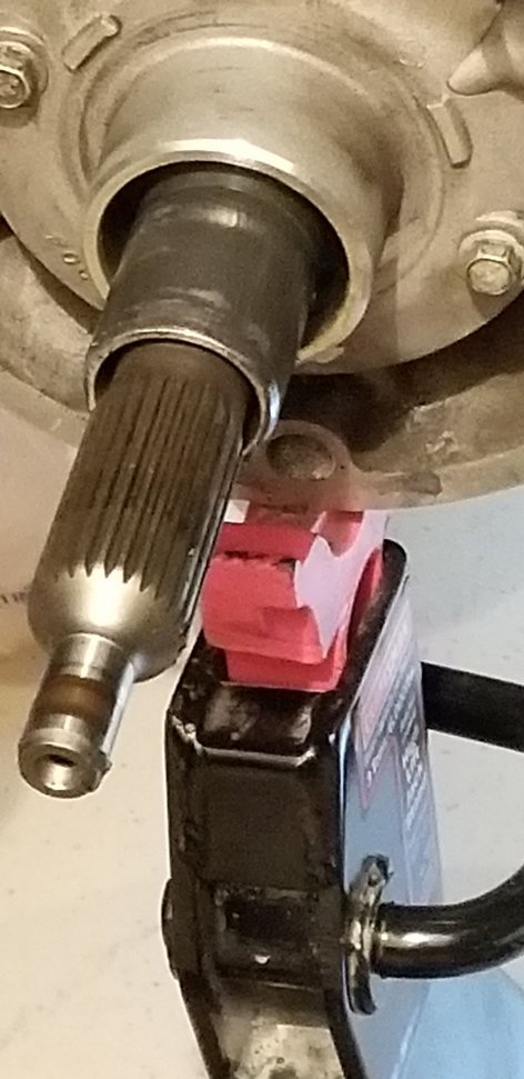

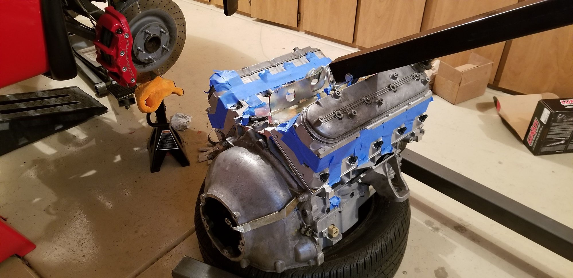

tommypenguin's Avatar
tommypenguin
Joined: Jul 2011
Posts: 1,599
Likes: 398
From: Boise, ID
Originally Posted by Tusc
So you're saying leave the clutch and flywheel connected along with the bellhousing to the block, disconnect the slave cylinder hydraulic line, and unbolt the rear of the bellhousing to the TT.
Does the TT just pull straight out of the clutch?
Correct, leave it assembled and pull out as one assembly, here are a few pics of when I was reinstalling my engine. Will slide off the input shaft at pilot bearing connection, then you're good.
