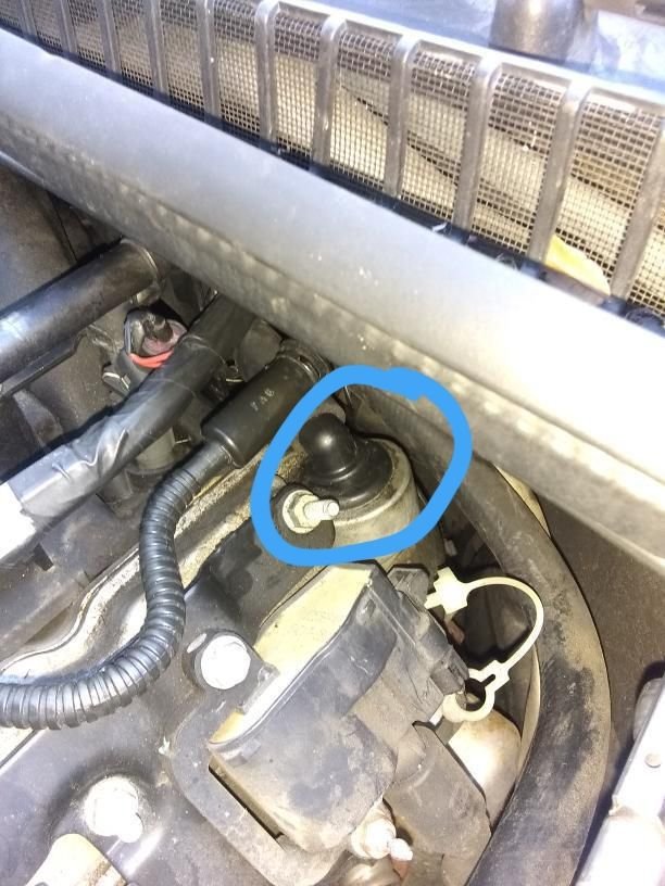

Got in there and sprayed under car with brake cleaner. Sprayed a little behind motor etc as well and i notice this. The valve circled in the picture was totally not connected and kind of sitting sideways atop the hole. There was oil residue inside but i didnt see a whole lot around the area. Could this have been a potential cause as well?

Let idle for about 10 mimutea and a pretty big puddle of oil formed on the cardboard direclty below the lower portion of the oil pan. Could be drainage from the oil that was cleaned off with the brake fluid but it was pretty dark. Does this sound like a pan gasket issue?
