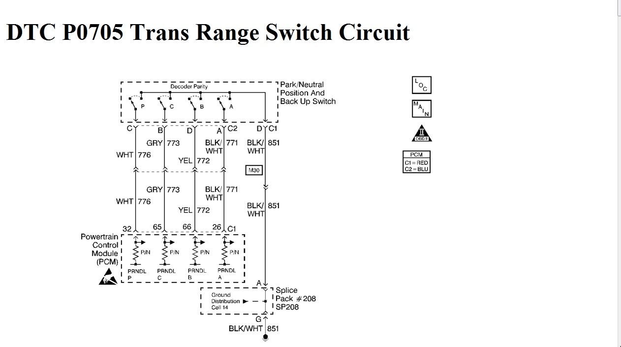

Your Trans range switch is probably not working properly .
If you have a Scantool like Tech 2 you can verify if the position of the switch is correct according to the gear shifter position .
Each switch is grounding the corresponding signal from the PCM , so it should be possible to use a multimeter and measure the individual range switch contacts without a scantool and check if they operates correctly .
