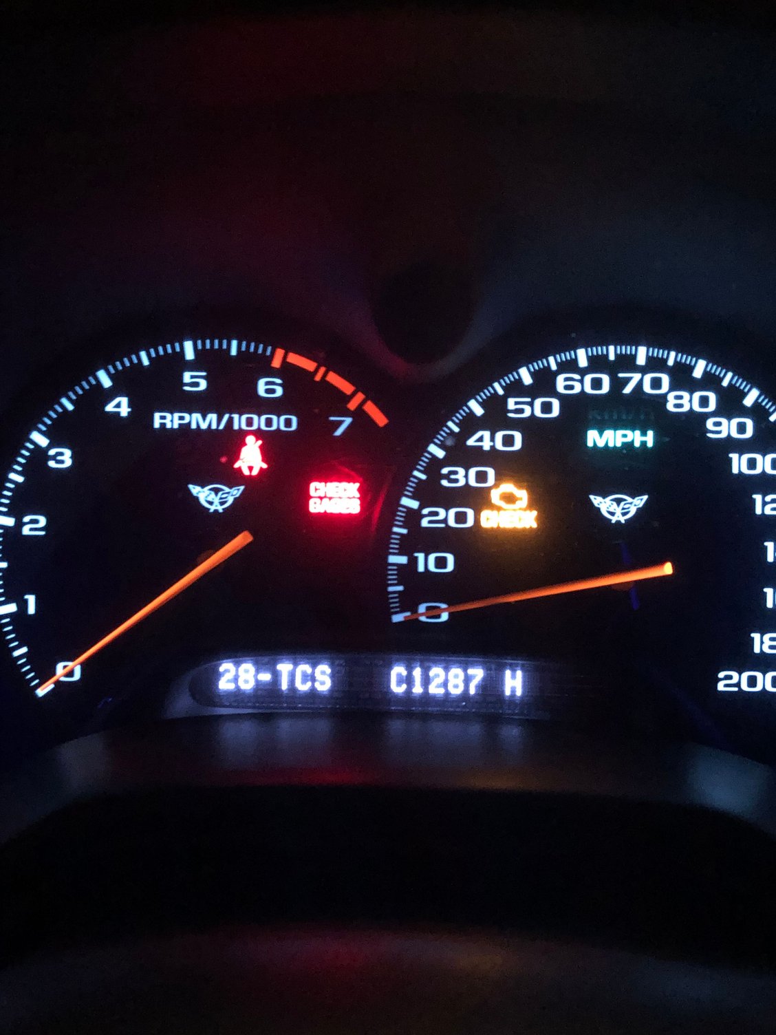

Clear all the codes and go for a drive to see what comes back. I’ll bet 1287 comes back which means you need a new steering sensor. Lots of threads on this for you to read.

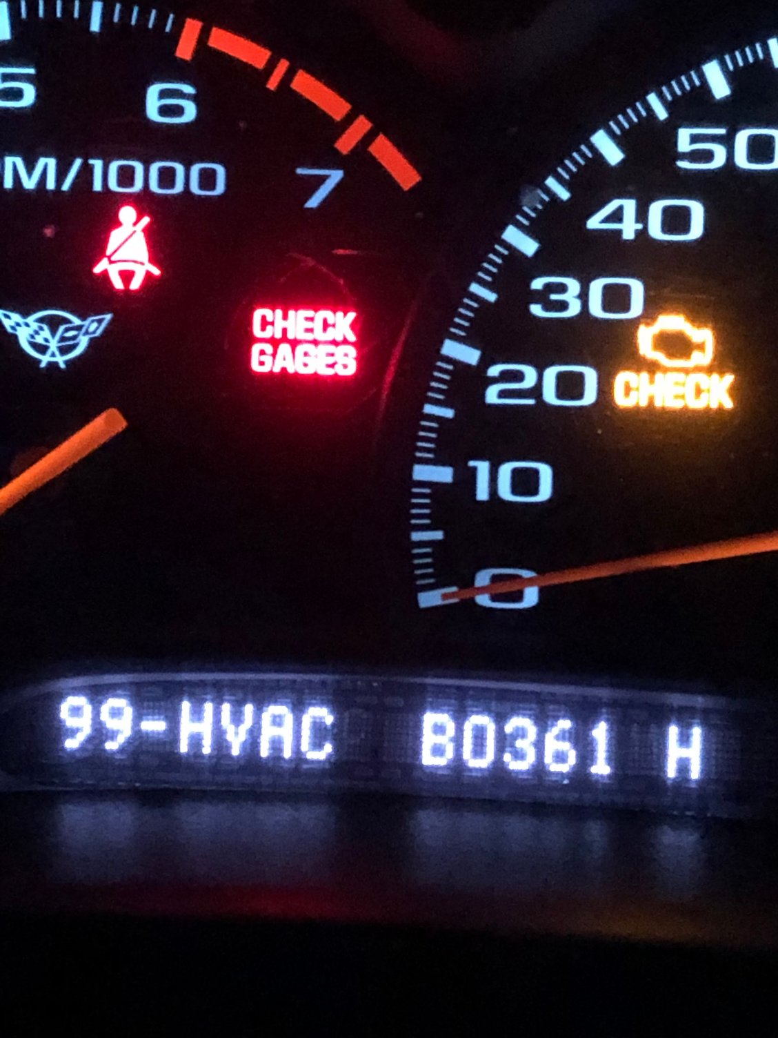

Took the car for a drive and no codes, right now. If I’m not mistaken, HVAC is probably from when I had the control unit out of the car to have the back lighting replaced.
what are the other codes?

Other codes don’t matter. They are h codes aka history codes. Only matter what comes back. Drive the car until the tcs warninf
cokes back and run the codes again.

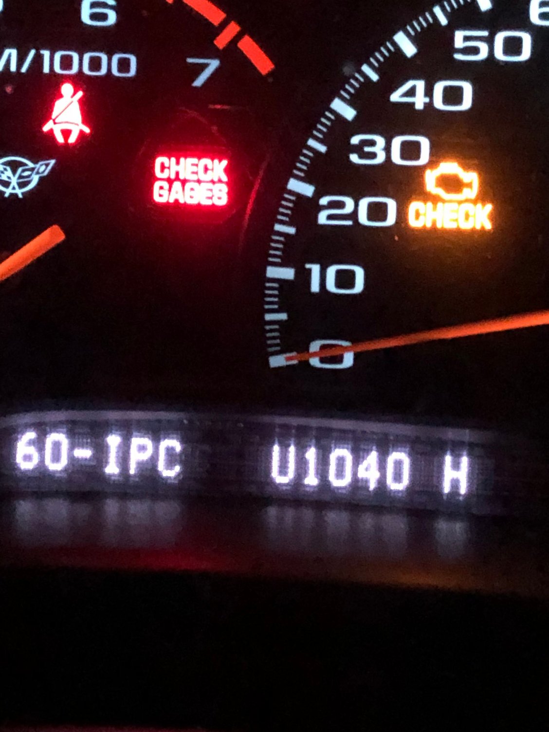

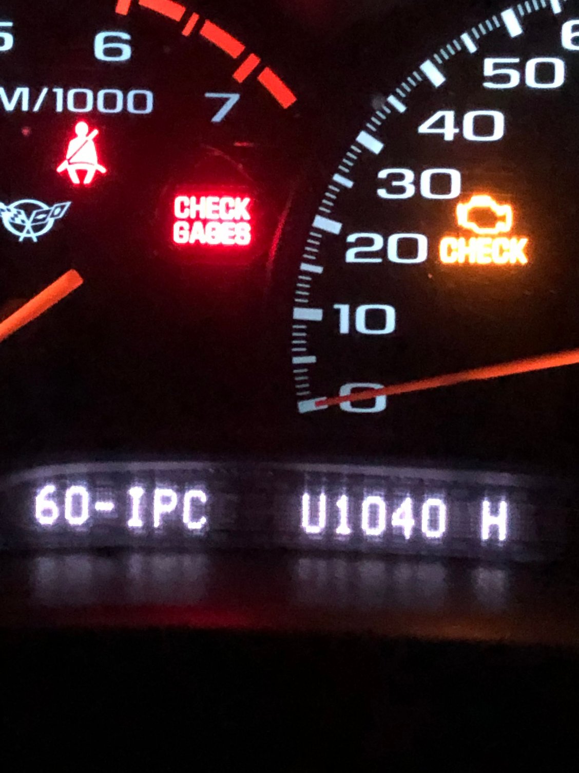

Old Nov 15, 2019 | 08:00 PM
C5 Diag's Avatar
C5 Diag
Moderator, Tech Contributor
Posts: 15,600
Likes: 4,060
From: Cape Coral, Florida
The U1040 is the IPC couldn’t communicate with the ABS !!...they are history codes so clear them and see what comes back..check for DTC before you turn the ignition off !!
