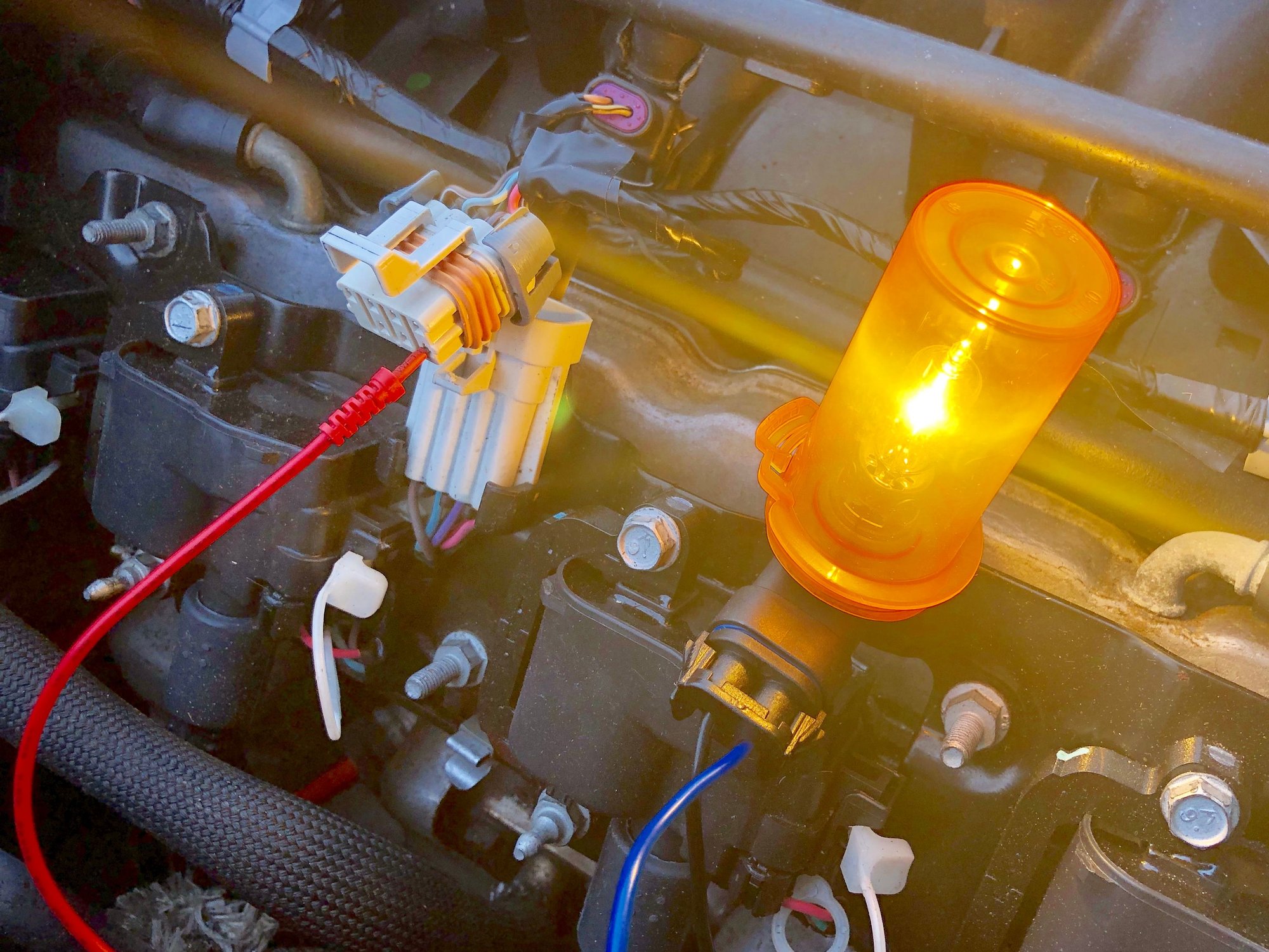

Being that you said the pump is making a weird sound we should try to rule that out...you can check pump current flow using pins 87 and 30 with the DVOM of the relay and also checking pressure will confirm that the pump is OK !!...I would say the injectors are OK if only sitting for a month...and does it still start for a bit then stall ??
Can you expand on how to do this?

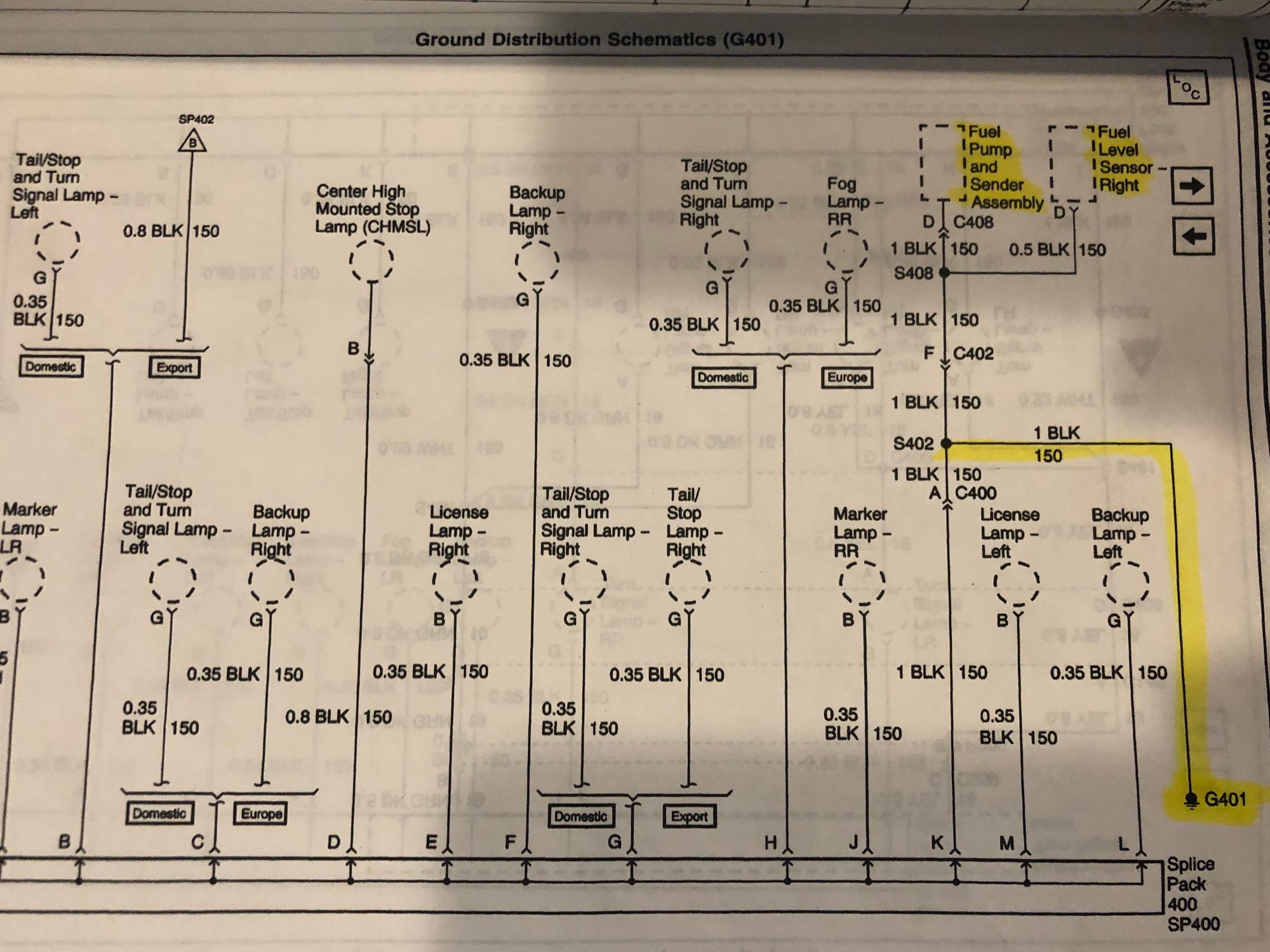

As you can see the ground for the pump is also ground for your blinker and brake lights....I’d remove G401 clean it and re install !!...I’d do a ground to ground voltage drop check between the pump ground harness and G401 with pump running !!...here is the wiring !!..now in the video I used a test light...not the best way to load a ground...I should have used my old headlight bulb and connected that to battery positive and pin 30...that bulb draws a little over 4 amps instead of the test light which draws around .05 amp !!

Didn't the P30 to 12V power test with a test light validate G401? I have tested G401 with a test light separately.
It is not just that the tail lights and blinkers are not working. When engaged the brakes make the dash and fog lights illuminate and the blinkers make the entire dash blink. I did just notice that the curtesy lighting in the hatch area is working.
I was also able to validate that the reverse lights and tail lights were working when I pulled out of the driveway via our security cameras. This further ties all the issues to starting at the same time.
Thanks

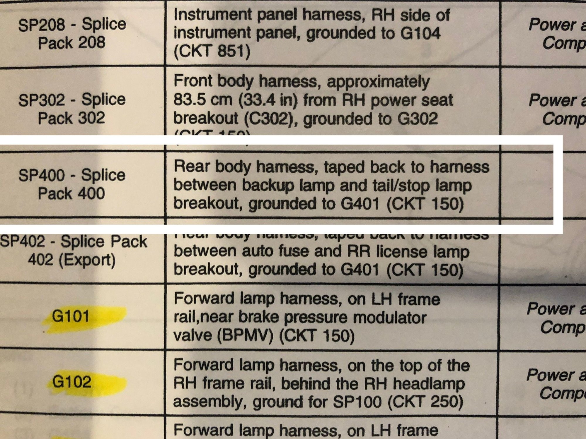

Just checked what I think is splice pack 400 after pulling the right tail lamps. It was tapped to the harness. Pins looked great.

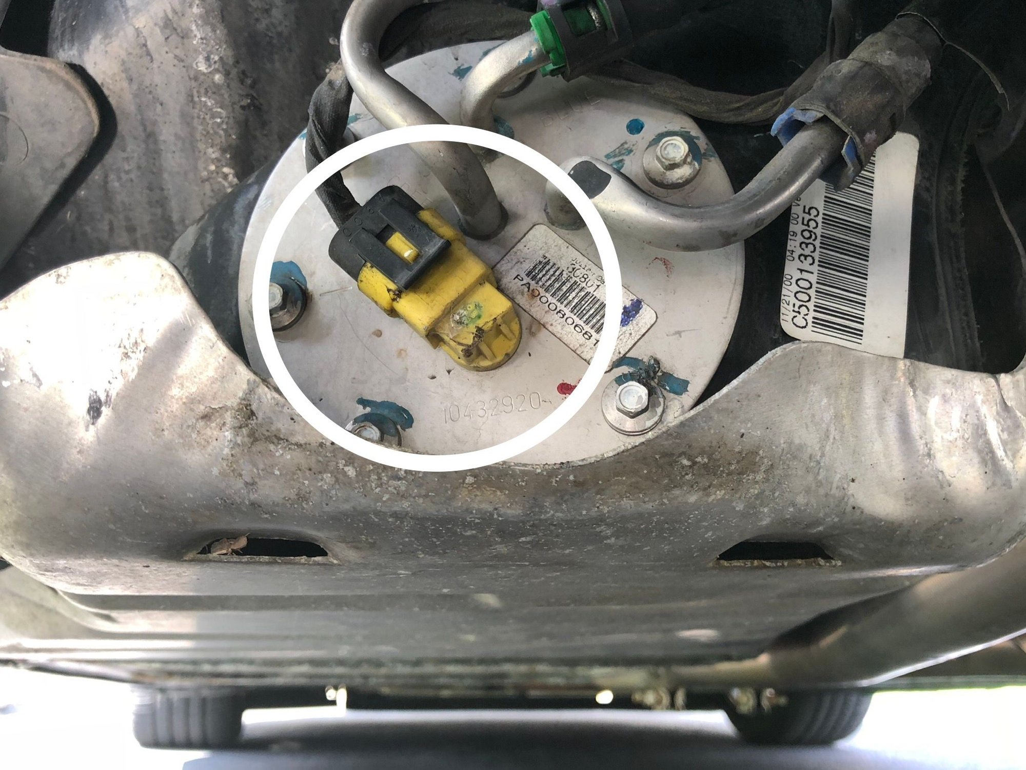

You must remove the metal access cover to get to the pump and harness...easily seen from underneath !!...might be a good place for mice to hide !!
