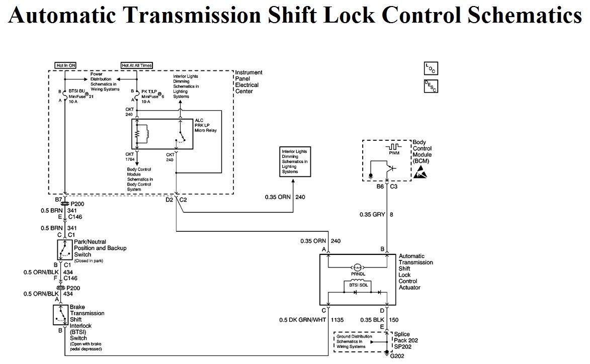

If you can´t get your car out of park ,maybe your shift lock actuator is stuck . Here is some pictures and the schematics .
