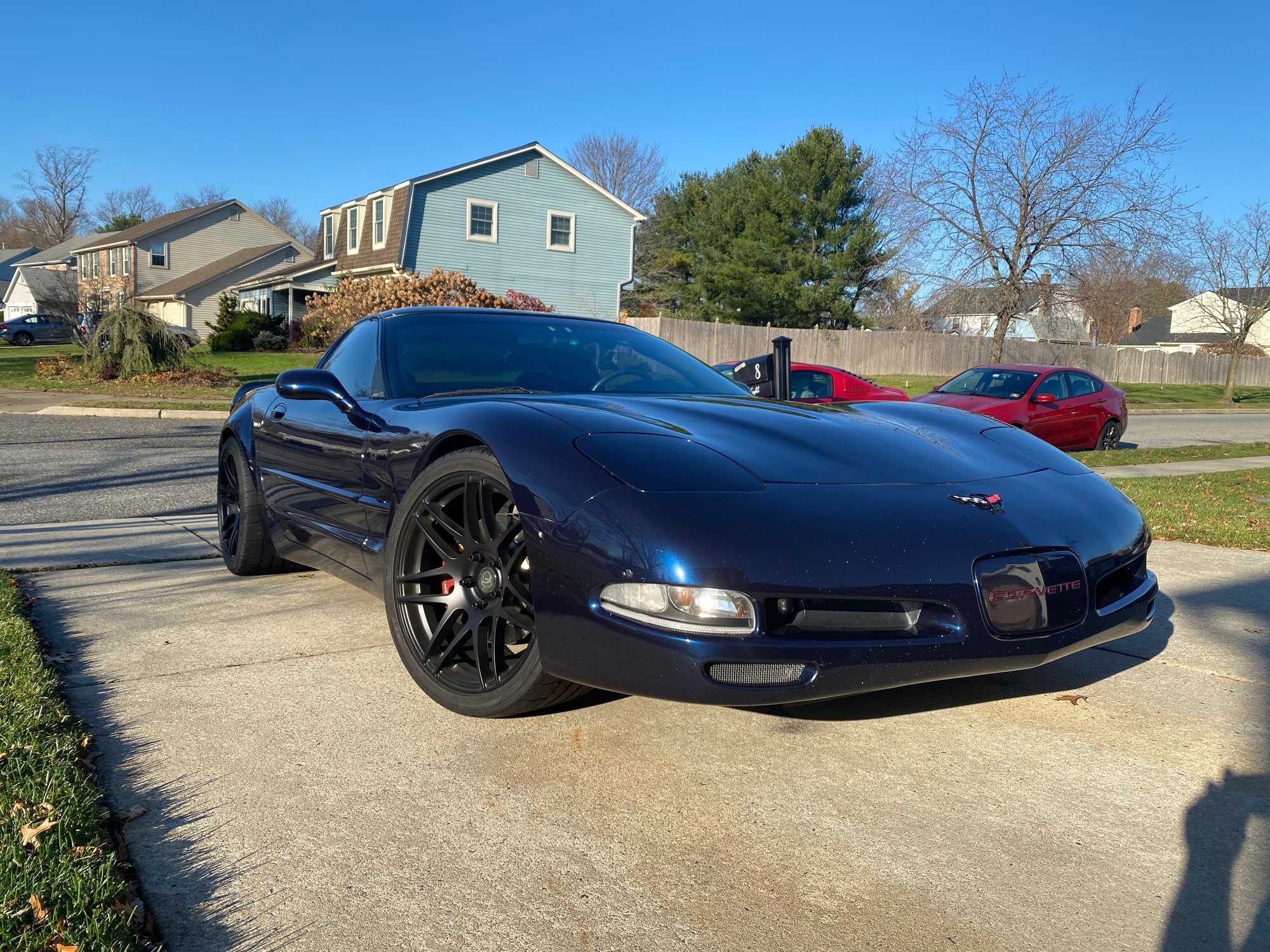

I thought the Lewis Five fenders I bought were right at 2”. I do have a little extra space in the rear with the 39mm offset on a 12” rim and 325 tires, but not enough that it doesn’t look correct.
I do have a second set of rims - three piece Boyd Coddington wheels. On the rear I replaced a 2.5” outer rim with a 5” outer rim which gave me nice deep wells and a 12.5” rim width. It moved the offset to right around 24.5mm . . . and with a Michelin 345 on the rear I have a little rubbing when the shock contracts. This was the primary reason for the new set of wheels - to get lighter wheels - more grip in the front - and better tires for HPDE.
Old Dec 5, 2020 | 11:40 AM
Dave B's Avatar
Dave B
Joined: Nov 2005
Posts: 72
Likes: 5
From: Sewell NJ
The new Forgestar wheels
The old Boyd Coddington wheels

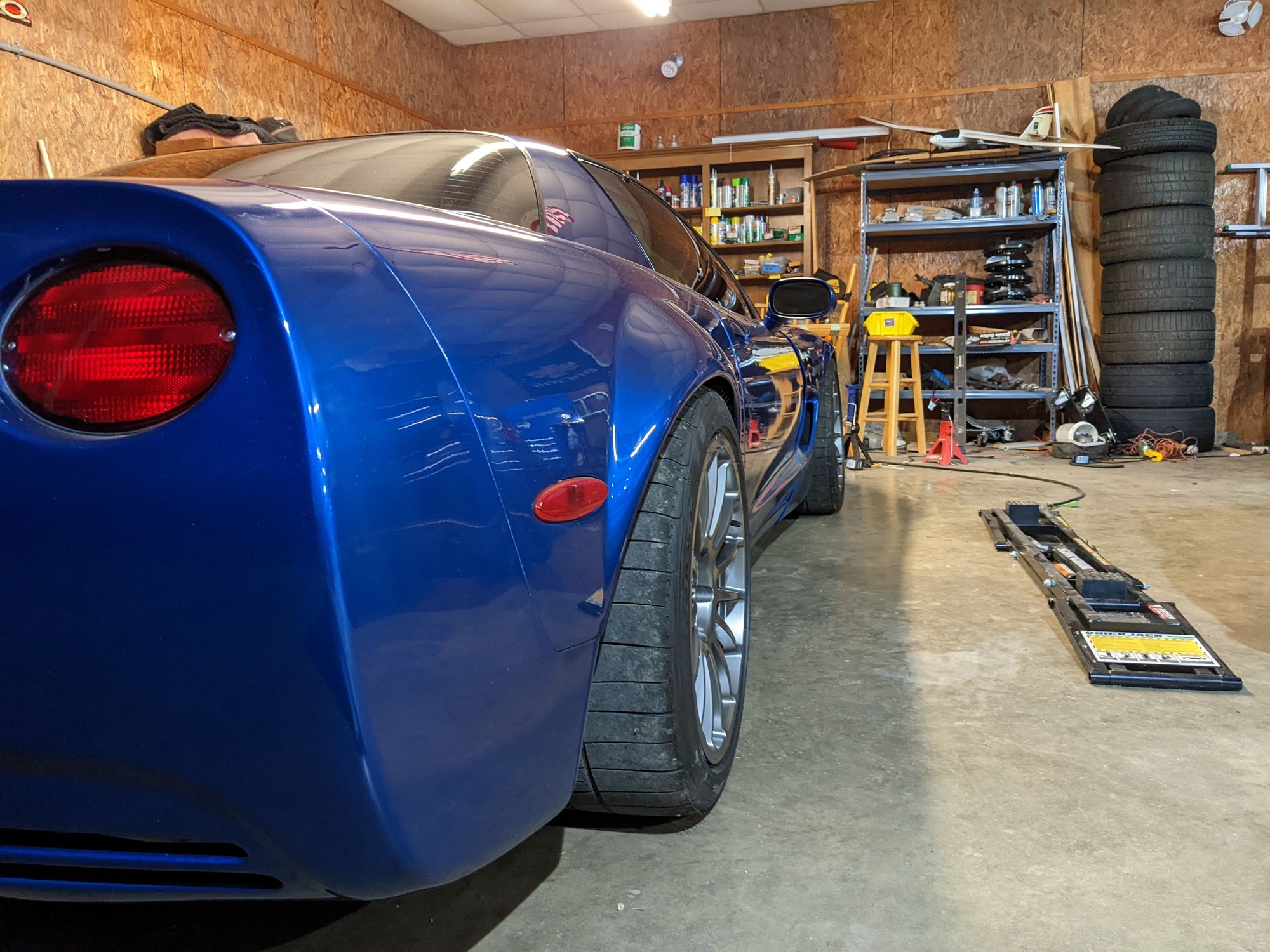

That puts you in no man's land unfortunately. Can't run more than a 1/4" spacer on stock studs and smallest bolt on spacer you can run is a 1" or else the stock studs won't let you fully seat the bolt on spacer. Here's a picture of a 19x12 +45 (more aggressive than usual C6/C7 spec) with a 345/30/19 Michelin PLUS a 1/2" spacer...in my opinion, it's still way too tucked.
Thank you for the pic…I’m seeing what you’re seeing….so, with that being said, do you have any pics of the 19x12 (+59) with 1” spacer? I do appreciate your input!
