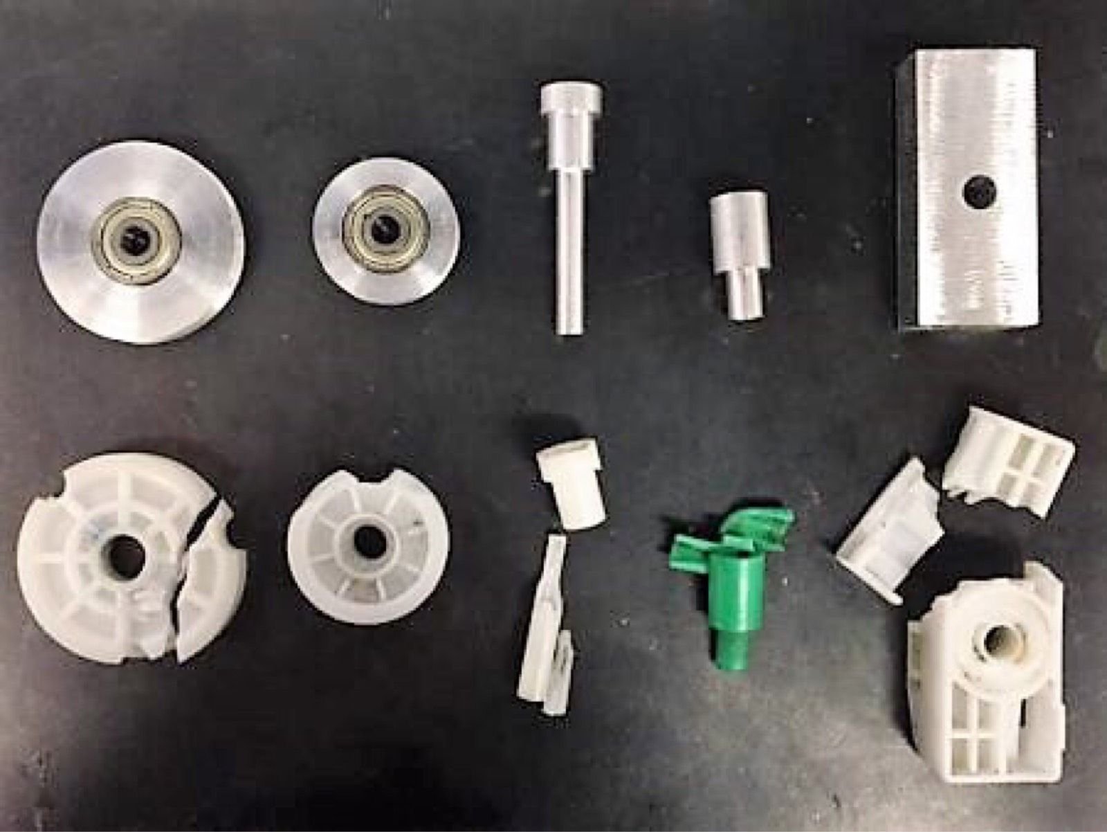

Hey there we are a new vendor sponsored on the site. No need for rudeness, we can all get along. We're here to provide high quality metal repairs as an alternative to the cheap plastic pieces that normally break on window regulators. I'll leave a picture of our products for reference. We have specialized in rebuilding regulators for over ten years. Please feel free to have a look at our reviews as we have a near perfect rating on yelp and google. We are the only shop in the country that manufactures our own metal part for these repairs.

Oh. Ok. Welcome! Are those c5 parts in your picture? Also, a majority of c5 window regulators fail because the wire cable starts coming apart/shredding causing a crunching noise. What do you offer to strengthen that point of failure? Thanks.
Usually if we see the cable is shredding or falling apart, we replace the cable. Typically we find that the cable becomes damaged due to continued use after a different component on the regulator has broken. After we rebuild and strengthen with our metal parts, the parts we install are designed to handle more load than the plastic parts, so very rarely do we have any recalls for the cable shredding after that. The parts in the picture are universal, so they fit the c5 as well as the newer corvette regulators.
interesting. Thanks. What is the warranty you provide? The oem is 2 years so I’m assuming yours is at least 5 or more? Thanks.
