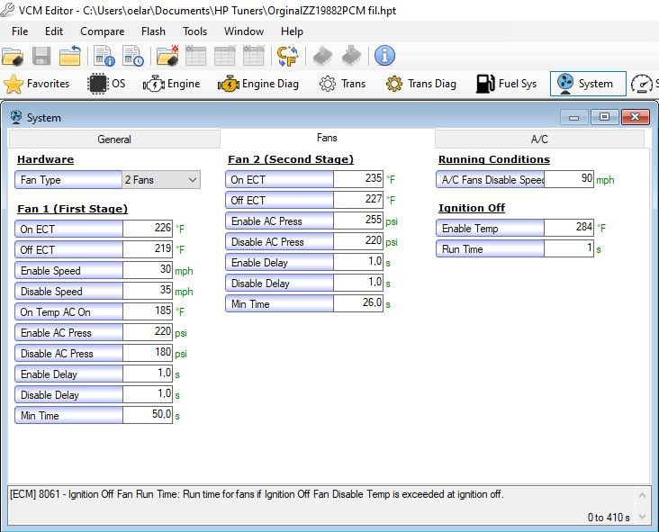

You need the HP Tuner software (VCM editor ) or similar software to change the settings shown below
