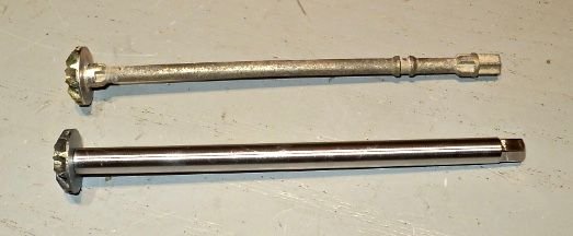

It looks likes that the piece I need. I am a little confused about the product and description. When I purchase an I sent the new rod or so I need to make it with parts supplied? How har is this going to me?

screw/torx end

You will assemble a new one using the parts from the kit and reusing the gear portion of your old golden rod. The step-by-step directions are in the link I gave you.
It is a DIY kit:
Original and new one side by side:
