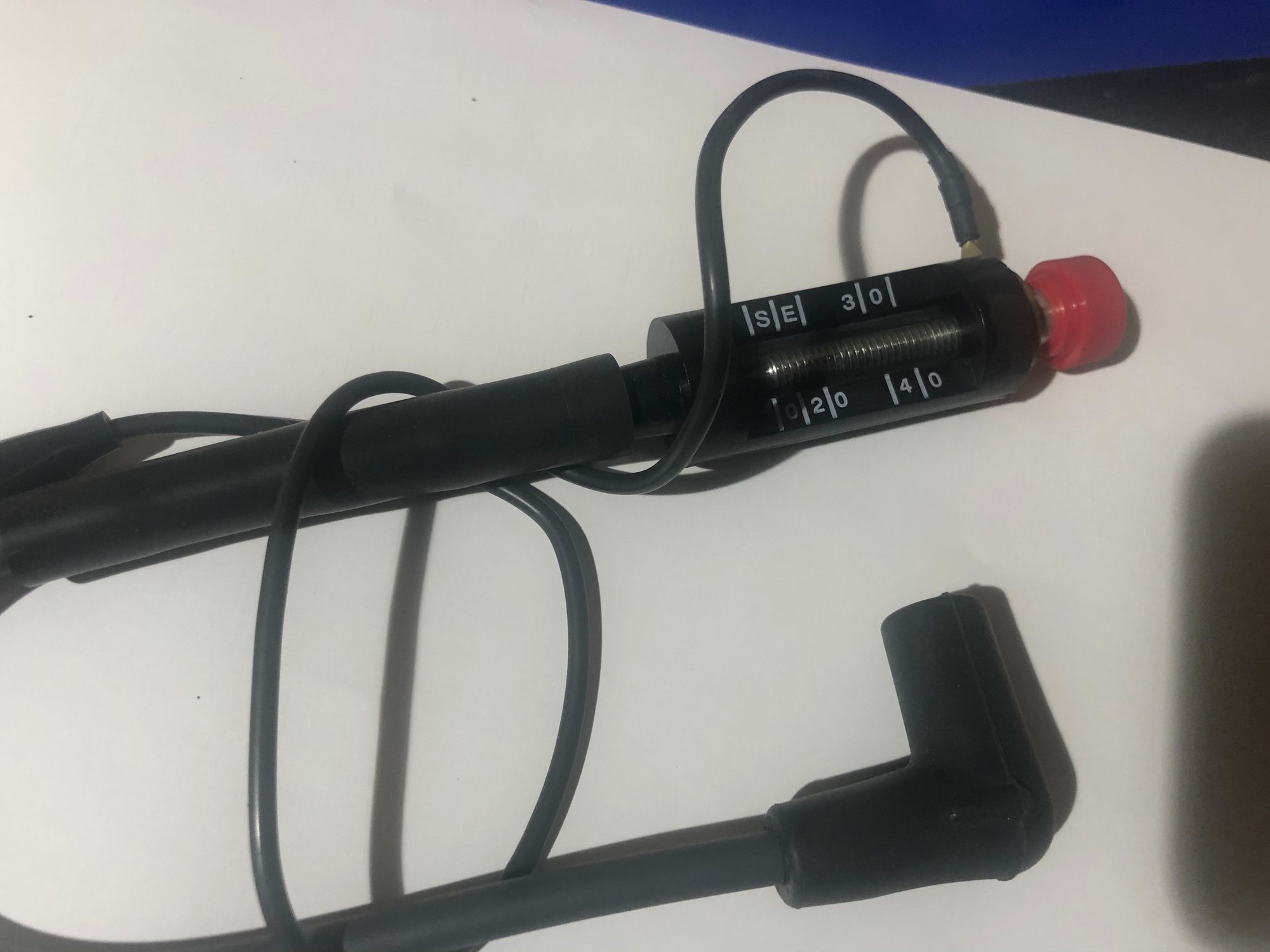

I did a YouTube video on doing a functional test of the coil packs on the control wire...the BEST way to check your coil packs is with a scope looking at your firing KV at idle and under load...these C5 coil packs are pretty bullet proof but like I said it may be cheaper in the long run paying for diagnostic time !!...and as I had said in the PM to you spray the secondary ignition system down with baking soda and water mix and see if you see a lightning show under the hood at night or in a dark garage...they do make adjustable spark testers that may help !!...mine is pictured be
low !!

hmmm, before you start messing with anything else try gapping them at .040 and see if that changes anything
