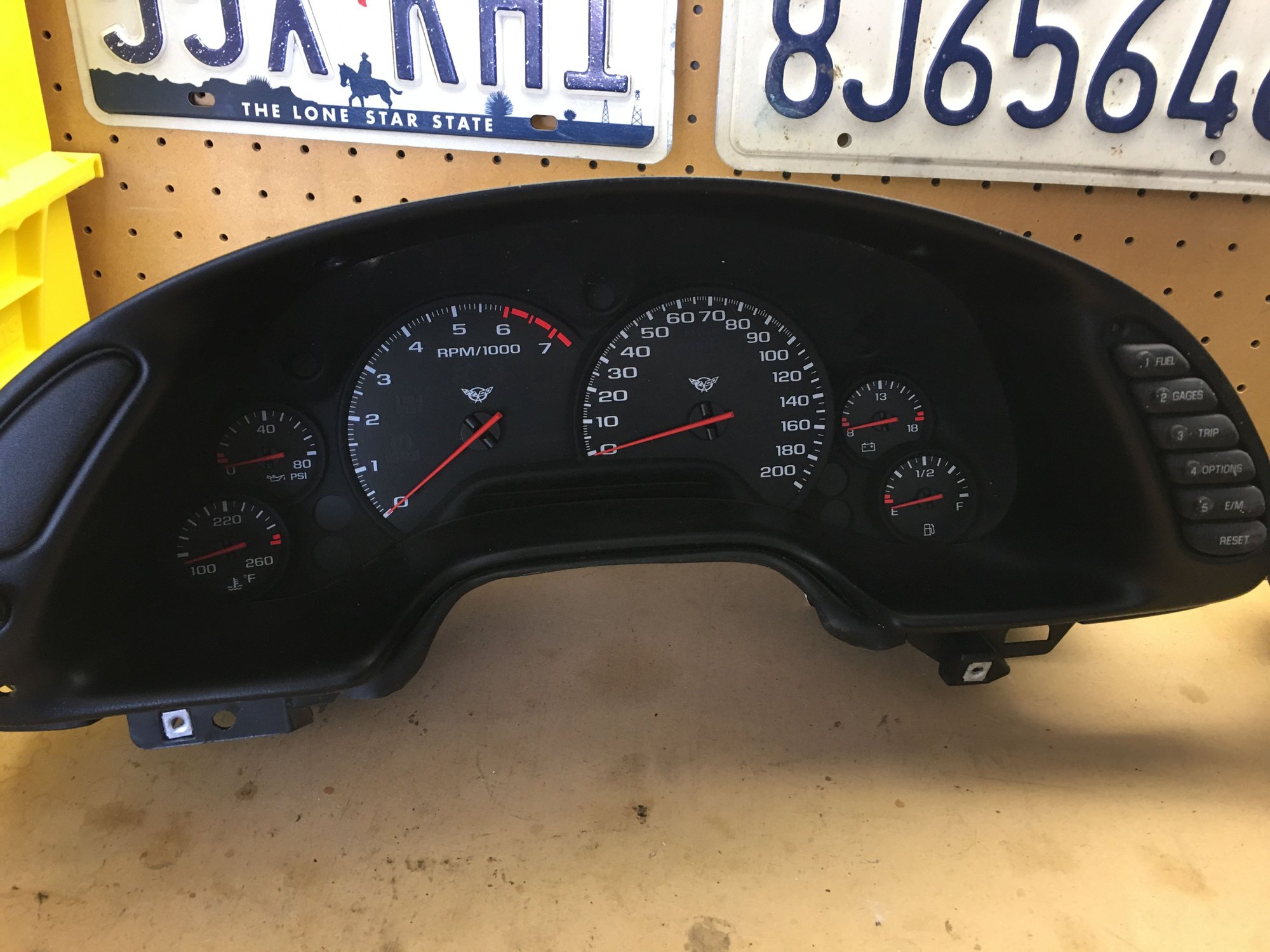

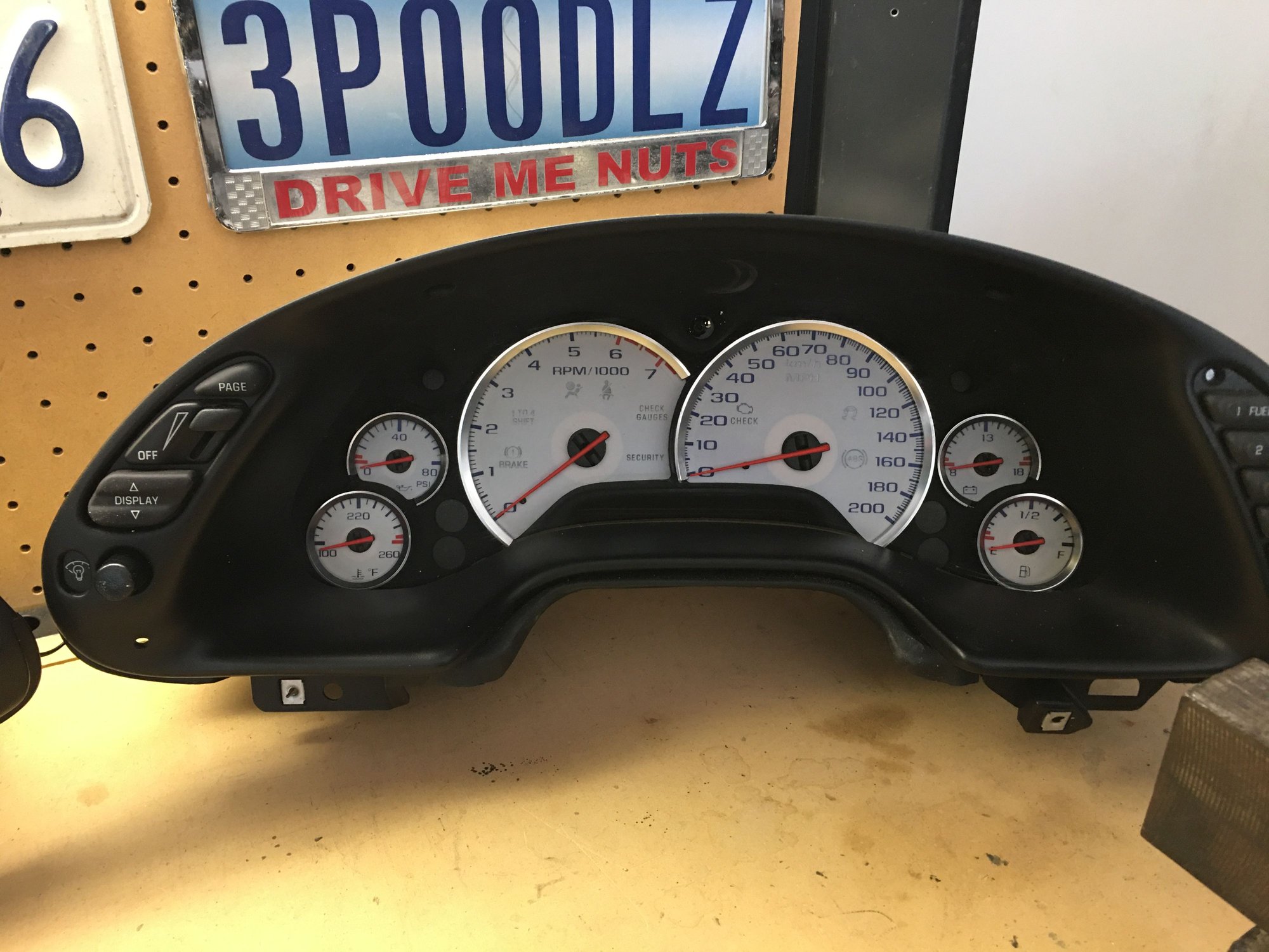

So I exchanged the instrument cluster in my ‘04 with the one I had previously in my ‘00 so that I could again have my white-faced instruments. But now it shows the miles from my ‘00 Instead of the correct ‘04 miles. What piece of the cluster do I need to change to get my correct miles back?

you would need to change the boards in the cluster. remove the ballast on the back and seperate the plastic on the back side. do you have heads up display in both clusters?

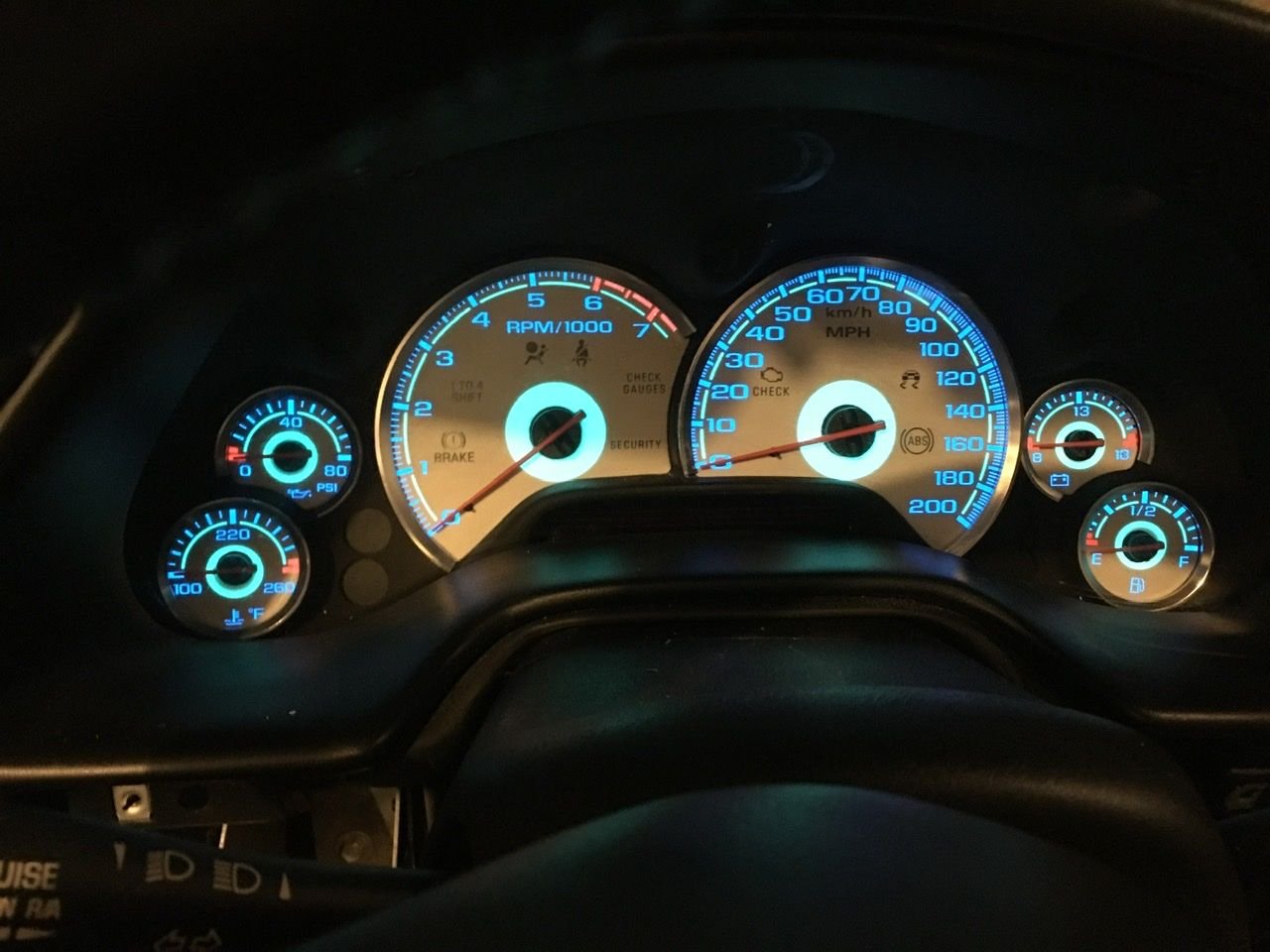

Circuit boards exchanged! Haven’t reinstalled cluster so not yet powered up. That will be the test. Picture, installed to follow.

Installation complete.

I cannibalized from a cluster I had previously used in my 2000 about 10 years ago. Just needed to exchange the circuit board and outer bezel to keep Heads-Up and maintain correct mileage.
