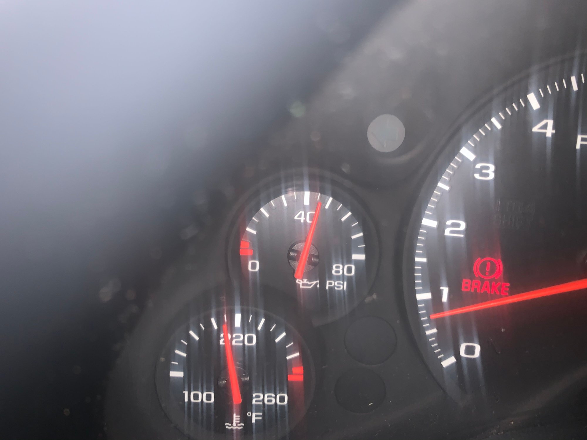

I have good pressure now that I have changed the oil but the tapping has not left I’m assuming a lifter collapsed since their wasn’t enough oil when the pressure dropped I will upload a picture of the oil pressure at idle but I have put the stp in the oil but the tapping seems to come back when the motor warms up
