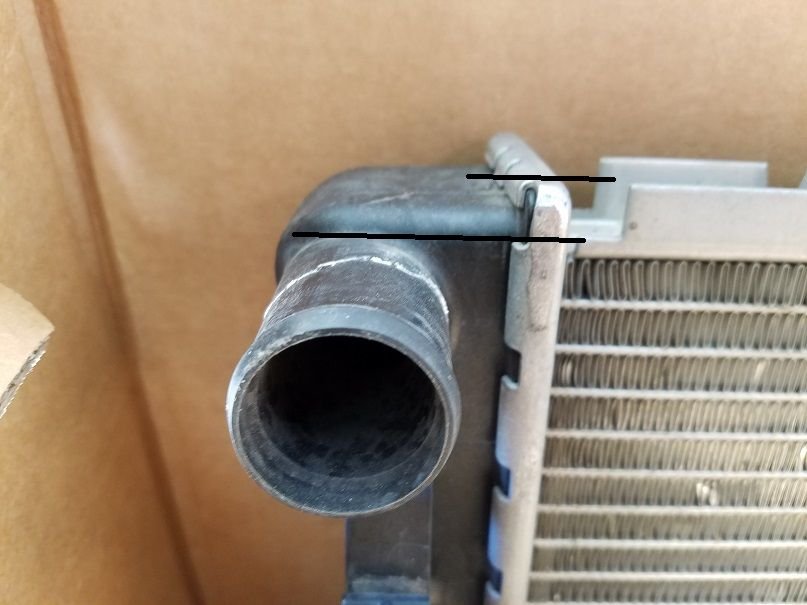

Here are my pics showing the upper hose interference I have with the brake lines with my DeWitts C5 radiator. Not shown here is that the brake lines pushing the hose up in this area also causes a kink in the hose under the air bridge.
Thank you for reporting this, I never really noticed it on mine that the hose sort of touches one of my brakes lines, but I’m running the standard dewitts no EOC with a LS3/LS7 water pump, so the hose is a bit of a different angle. I wonder if running a different hose would help with the clearance, or possibly adding a thick enough layer of rubber or neoprene padding where the radiator sits were to help with this clearance.

These two pictures I believe sum up the problem DeWitts has with their C5 radiator when put into later models with the ABS module in front. Their 'core' is a little shorter than stock, so they had to add a bit to the top and bottom mounts to make it fit. Probably designed on an early C5, there were no brake lines in the way, so they added some height to the top mounting ears. This essentially pushes the upper hose connection point 'down' in the car, which puts the upper hose into contact with the brake lines. A simple redesign would fix it, even just a slight angle up to the upper hose connection would do it.
