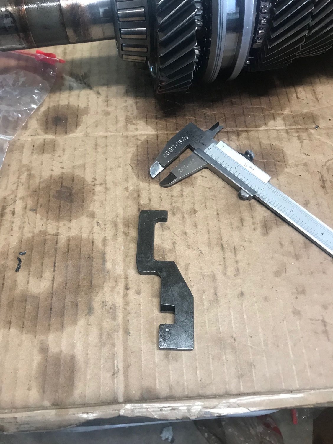

After measuring the existing pads and the mating components there are the drawings for the shift fork pads that i came up with. There is one mistake the internal rads need to be a 0.0625 max rather than a 0.625. Im working on machining these and will let you guys know how they turn out.

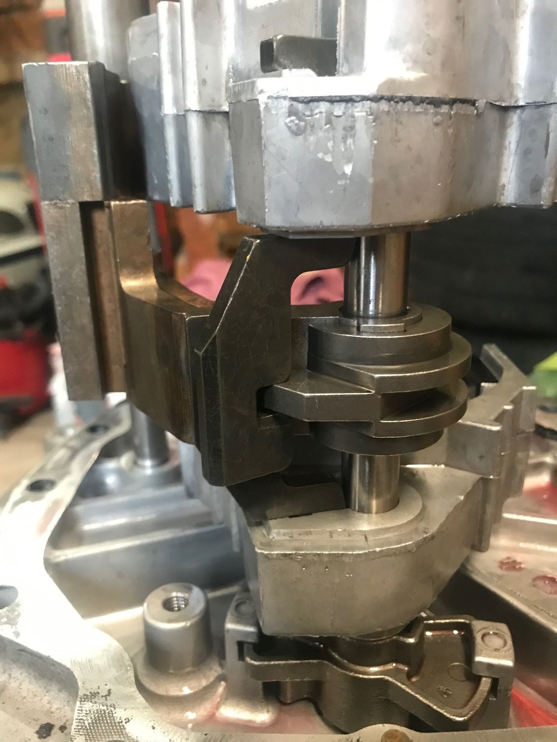

My next area of concern is the slop between the driving pin on the shift selector assembly and the shift fork linkages for 1-2 and 3-4. I was able to get some measurements which i found interesting. The pin responsible for transmitting the shifting action from the shift rod to the fork linkage measures at 0.255. However the gap in the shift fork linkage for 1-2 and 3-4 (pictured below) measures at 0.304, about 0.049 of slop. the most interesting thing is that the linkages for 5-6 and reverse, which are significantly different by nature, measure at 0.265, only 0.010 of slop which is much more reasonable. Its not that the 1-2 and 3-4 look warn or anything they seem to be simply built with more tolerance for some reason. Any idea why this extra play would be designed into these linkages and not the others. In the mean time I'll be looking into what i can do to tighten this up a bit.
Linkage with excess slop
