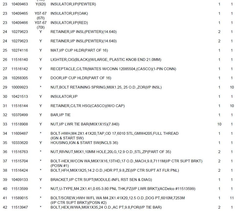

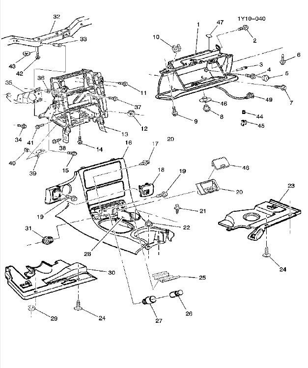

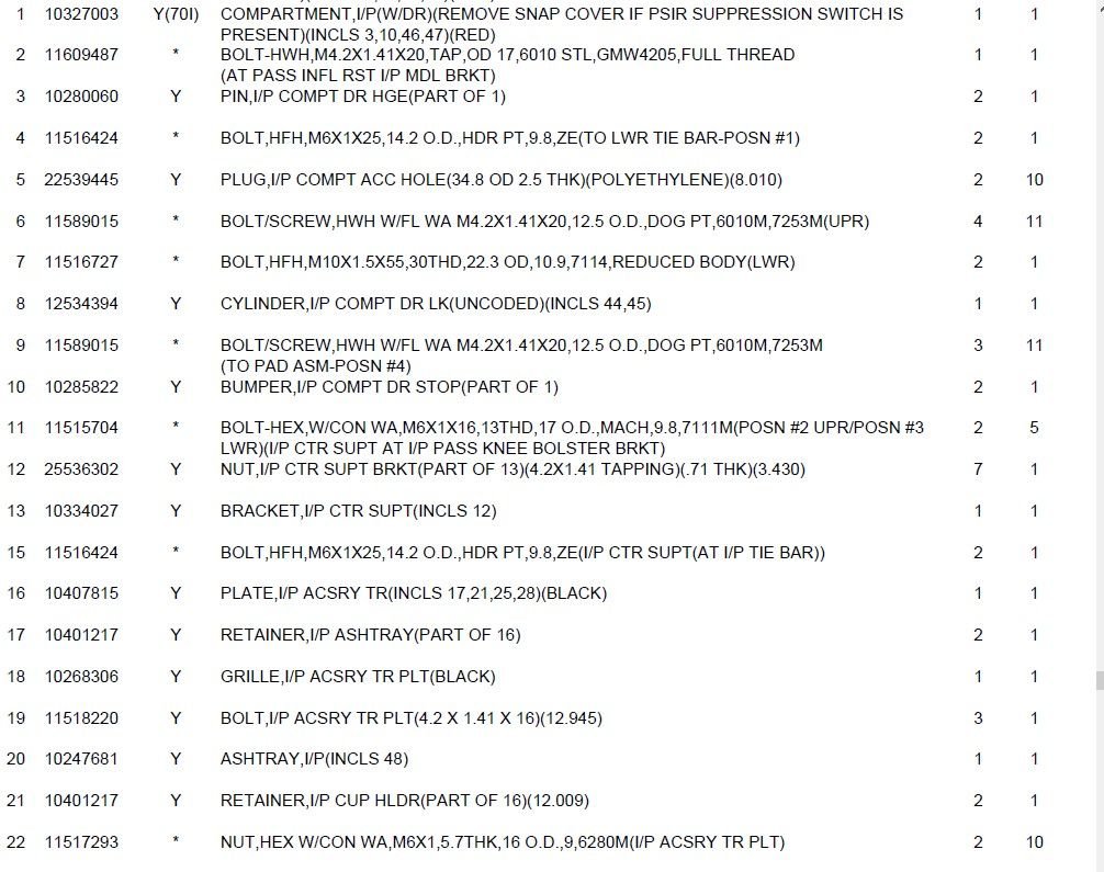

Old Jun 5, 2023 | 06:17 AM
LWSZ06's Avatar
LWSZ06
Joined: Sep 2009
Posts: 464
Likes: 160
From: Port Birmingham AL
Old Jun 5, 2023 | 12:02 PM
