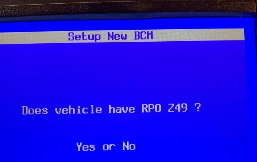

I have a 2000 mod and have a spare (used) 2000 mod BCM that I would like to configure so I can use it as a spare if my running BCM failes .
I connected my J42236-A to the star connectors so my Tech 2 only communicate with the BCM .
The Tech2 communicate with the used BCM and I enter the special functions to set my RPO's correct and this seems to work .
When I have changed the RPO's I enter Save Options I get the message "Now Setting Up the New Body Control Module" and after a few seconds I get the message
that communications with the BCM has been lost and I am requested to check the communication link.
When I enter the BCM RPO's once again they seems to be changed like I wanted .
Is this correct way of setting up a "new" BCM ?

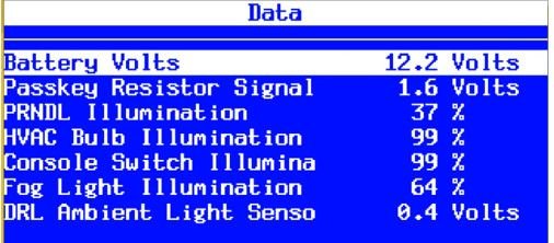

When I programmed my spare PCM yesterday using SPS , I used my J42236-A serial tool to split and isolate the PCM when programming it.
I did not remove the J-42236- unit when I did the SPS relearn ( 10min) which I should have done so the BCM and the PCM could communicate , but learning by doing so I will do it next time
So my theft relearn yesterday(screen shot below) did not carry out any communication between the BCM and the PCM due to the presens of my J-42236-A.
I guess the relearn sequence read the passkey voltage from my ignition key read by the BCM and store the value in the PCM's EEPROM .
If I enter a different key value meaning another passkey voltage the voltage read by the BCM will not match the value stored in the PCM and a no start condition will appear (I think)
My big question is now: If I replace my BCM with a used one or a remanufactured , The only two things I have to do is to configure the RPO's in the BCM with my Tech 2 and do a theft relearn and I will be good to go ?
No need to enter VIN or anything else configuring/programming ?
Or will a new/remanufactured BCM give other options within the Tech2 menu then I used one ?

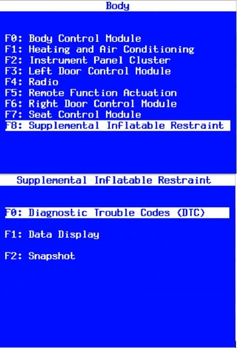

My car started fine with my spare PCM and BCM , but I am stuck with this SIR code .
I can delete it , but it reappear everytime I start the car .
I guess some wrong SIR data(Restraint ID ) is in my spare BCM .
The Tech2 give me no alternative to change this any SIR data in the BCM , only the RPO's .
If I had a new or remanufatured BCM will I got an option to enter SIR data ?
I hope someone with this knowledge could give some info on this
Thanks
Old Feb 11, 2020 | 08:03 PM
lionelhutz's Avatar
lionelhutz
Joined: Apr 2007
Posts: 11,152
Likes: 890
From: South Western Ontario
Did you put the VIN into the PCM?
You should have tried one at a time....

I do not know if this is correct or not , but will check it out .
When using year of 2000 I can't see such options when using the Tech 2 ( I miss a Special Function in the SIR module menu) .
I noticed when I did Automated Bleed of my brakes and EBCTM , the Automated Bleed was not available for my 00 car and the 1999 car . I had to choose 1998
before Automated Bleed was a selectable choice .
I will play around with different years within the Tech2 menu and see if I get more choices regarding (relearn the BCM VIN number this issue causing B1001 DTC .
If this not work , I will do as you suggest and use my old PCM together with my spare BCM and see if this make any difference .
I had hoped someone who has replaced his BCM with used one could chime in on this with some more info on this .
