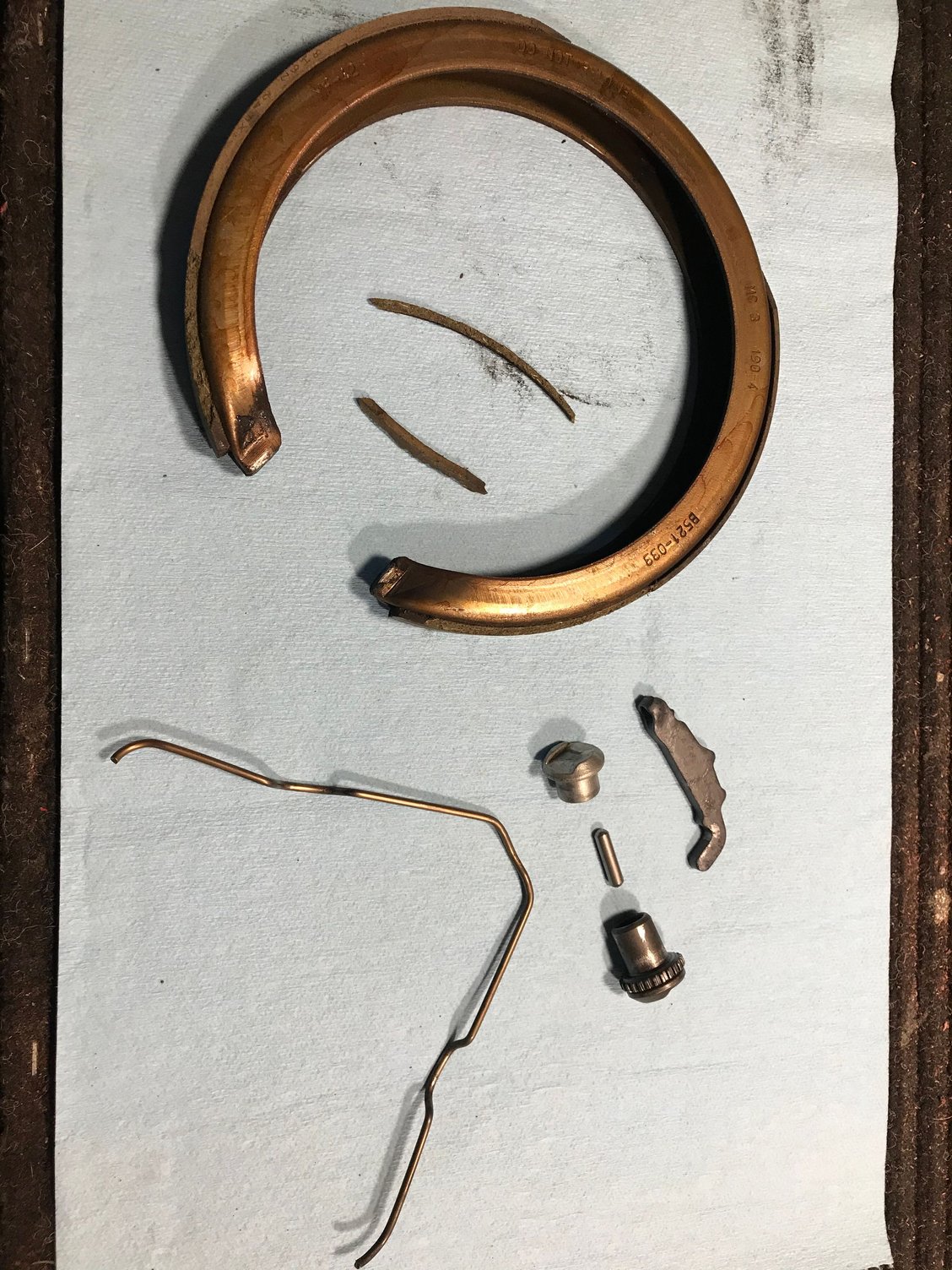

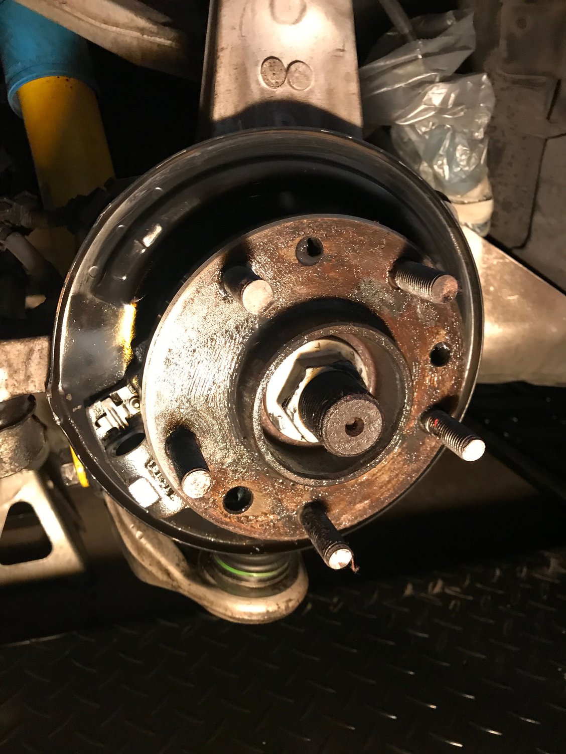

From reading an older post about a similar problem, I pried back the backing plate. From there, I could see the entire e-brake assembly was moving back and forth with the rotor. I also could see the adjuster wheel but could get it to move.
I originally thought I was about to get the rotor off before getting a view behind the backing plate. I detached the “wire” spring and that seemed to allow things to loosen up. I then yanked the rotor and brake shoes off as one piece. I’ll need new brake shoes and will rebuild the assembly.
Maybe this, along with the photos will help someone going through this same problem.

Thanks for posting the conclusion, or at least semi-conclusion. Far too often problem posts just seem to die of old age with no resolution. Do a bit of research on how to get the spring back on -- it's not a walk in the park. Looks like you pulled some brake material off the shoe? And the photo looks like one-sided wear -- is that an optical illusion?Did your backing plate end up bent? Wagner has a hardware kit for the parking brake, with not only the retention springs, but also the adjustment screws, etc. It's their H7426 -- duplicated by most brake parts suppliers.

I purchased a new shoe kit from NAPA and managed to get the spring clipped back in without losing my mind. I still have the driver’s side to do.
My old shoes looked okay (75,000 miles) but I damaged one during disassembly.
I pried back the backing plate and all seems to be working well.
I determined the passenger side adjuster was binding and a rebuild fixed the problem.
