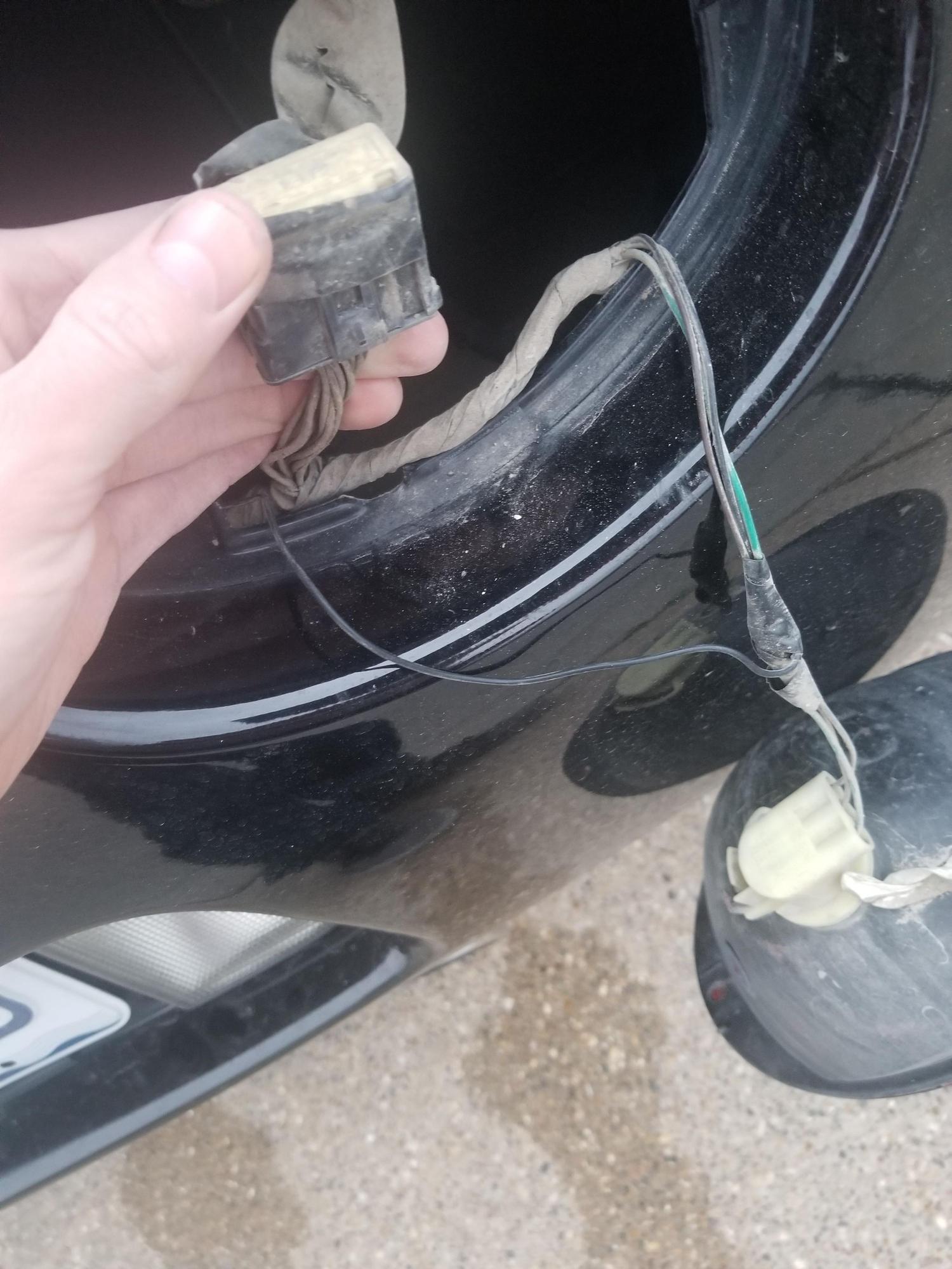

Is this the ground connection you are talking about that could be the issue? This little box? PED 1-12 https://imgur.com/a/kNDSv3G

Okay I found the culprit.
The previous owner spliced in that black wire (previous photo) to the green rear light wire that is under the tape, so when the center light was on (brakes on), it would make the right light solid and when the right blinker was on, it would make the center light blink too. I disconnected it and now the blinkers work fine, however, the brake lights do not work at all except on the center light. I also have no idea where the black wire is actually supposed to go to... It comes out of the center light and I believe it is factory but idk where it is originally cut from.
So yes now the issue is the right and left lights do not light up to their higher brightness like they should when you press the brake.
Also note I tried connecting that black wire to the black wire on the headlight instead of the green one and it just blew a fuse lol, so that's not the solution. I think my hazard switch is fine too but I have no idea actually, maybe it is the cause? I've heard some people complain about it causing issues.

The hazard switch has a contact that disconnects the left and right brake lights from the brake light switch and connects them to the flasher instead. So, I would now suspect the hazard switch.
Is the black wire spliced again at the center brake light?

The black wire went from the center light (I think it was connected there by factory, but I couldn't see inside the bumper well, just felt around with my hand), and whatever the other end was connected to was cut by the previous owner and connected to the green wire by the previous owner. I'm not sure where that black wire should be connected to but it surely isn't supposed to be just hanging there by ittself unconnected 😂
I also already bought a new hazard switch, should arrive in a week and I will install it to see if that fixes the issue.

Third brake light only has power and ground so if it works both of those are still connected to it and that wire must be an extra.
