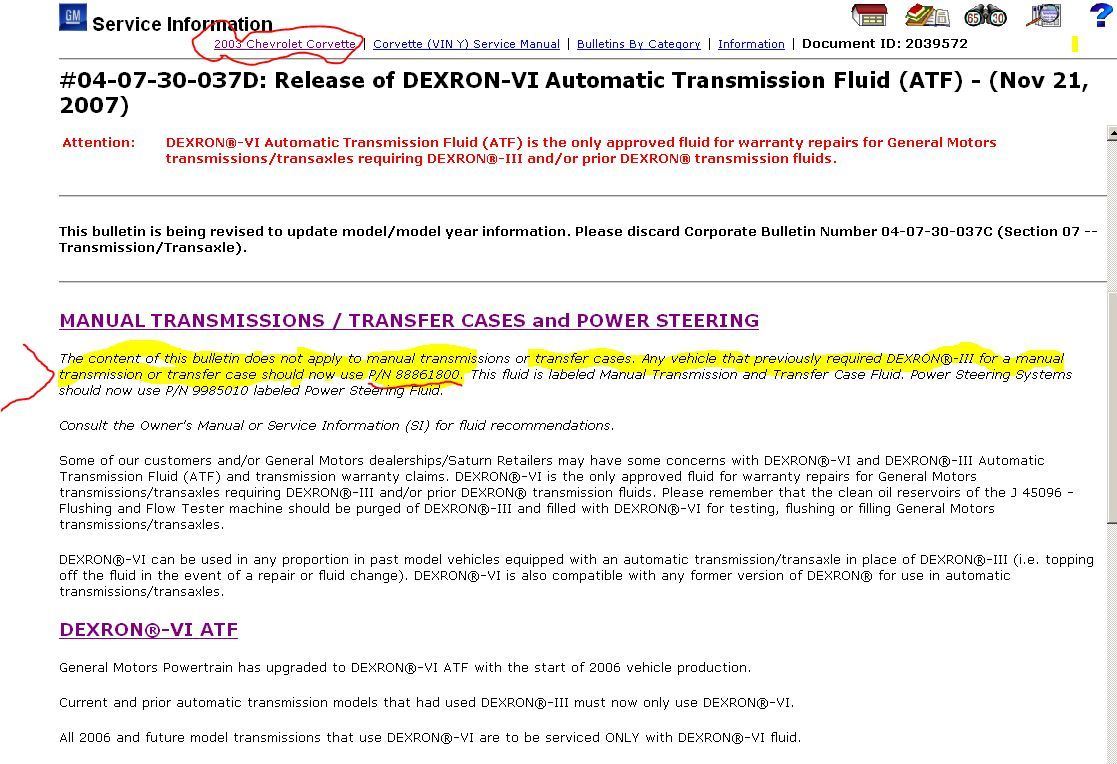

GM bulletin says to use 88861800, not Dex VI..
this is wrong. GM specifically recommends Dex VI. Contact the GM helpline and they will confirm.

From: Cedar Rapids IA
Show me the GM document that says it's wrong.

BTW, I can get quart jugs of the 88861800 at my local chevy in stock.. pretty cheap too !
So I'm down between 2 fluids. The 88861800 that people/gm/tech bull have said to use OR
