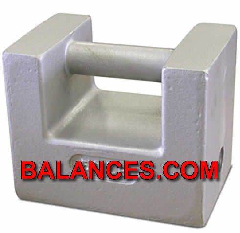

As did I. Instead of jack stands, however, i had my car sitting on (4) 50 pound, scale test weights. I find them to be more stable than jack stands, as they have more surface area for the car to rest on, with the "lifting pucks" in place.
I set them up so that one "side" of the weight is on the floor, and the "up side" has the car sitting on it. The side are 6" square, so they're quite stable, and in that orientation, they're 8" tall. If I happen to need more height, I have several pieces of 2x10 wood, that I can set the weights on. My concern, if I need to work under the car, is safety, and these weights provide it.
