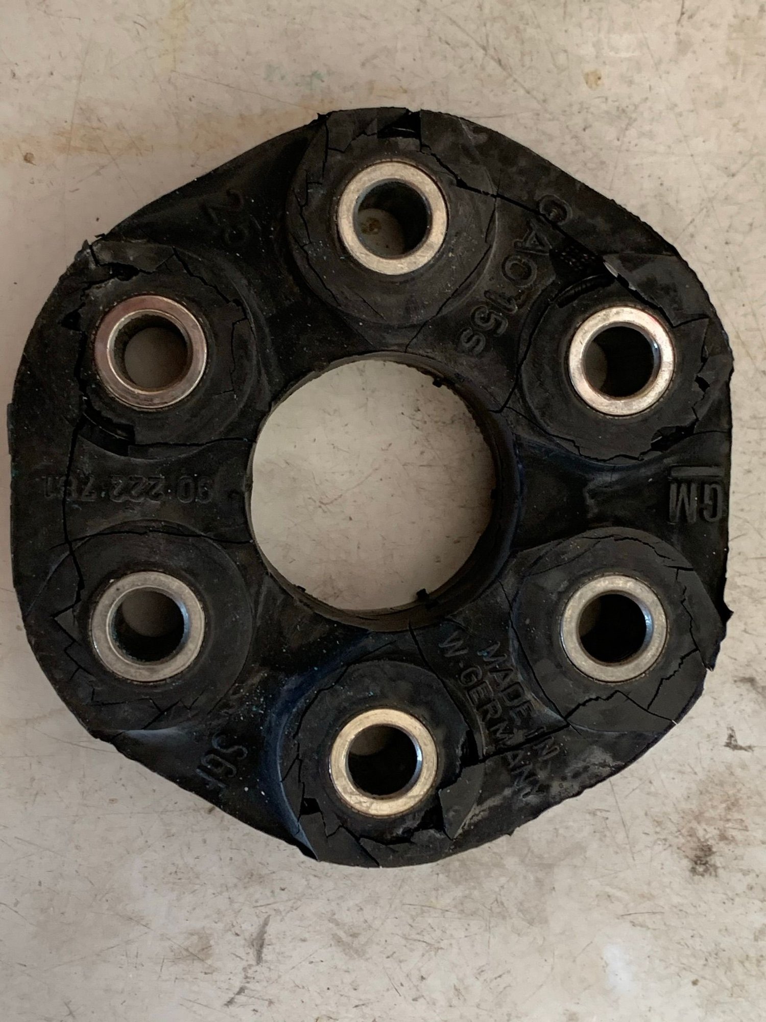

While you're in there and the trans/diff is down, look at the prop shaft's bearings, look at it's couplers, look at the mounts, and consider if you want to add a brace.
The bearings and couplers are wear items and will **** you off if you need to pull the entire assembly out again. It's several hundred for new OEM ones or similar quality. Some people go aftermarket and some people regret it. You can get solid couplers instead but they will need to be machined to match your application perfectly - I would only recommend if your car sees tons of track time, as it adds a fair bit of cost. (The parts are cheap, the machining is not.)
