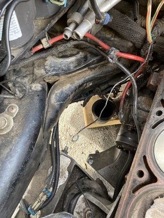

Well... I found the issue. It was a ground on the passenger side. The eye broke off. I soldered a new wire in place and put a new eye on it. It was the ground from my recent thread.

Originally Posted by C5 Diag
Which ground wire was it ?????
The one in the center of that picture (black wire with white stripe)
There’s an identical one bolted to the driver’s side head.
Is it G106 or 108 ??...what did you connect to ??
I’m not sure which one it is. It doesn’t quite reach the engine block grounding location so I connected it to the stud on the frame, where the battery and three other grounds are.

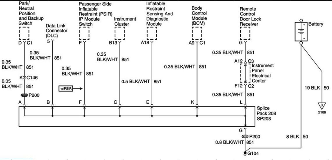

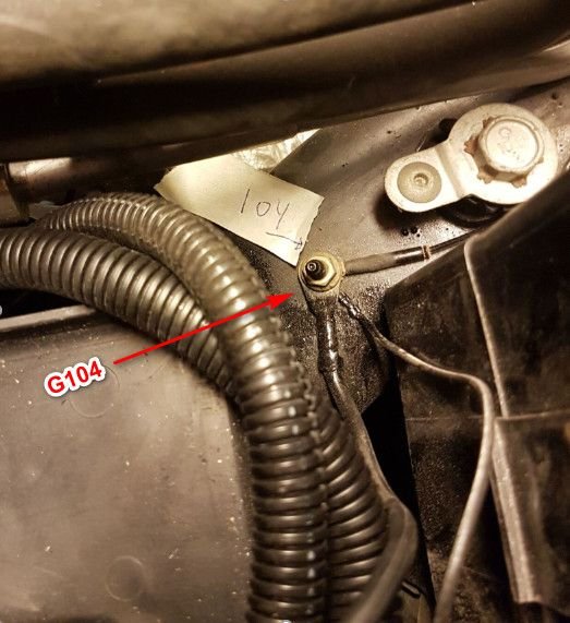

My guess it is G104 going to SP208
