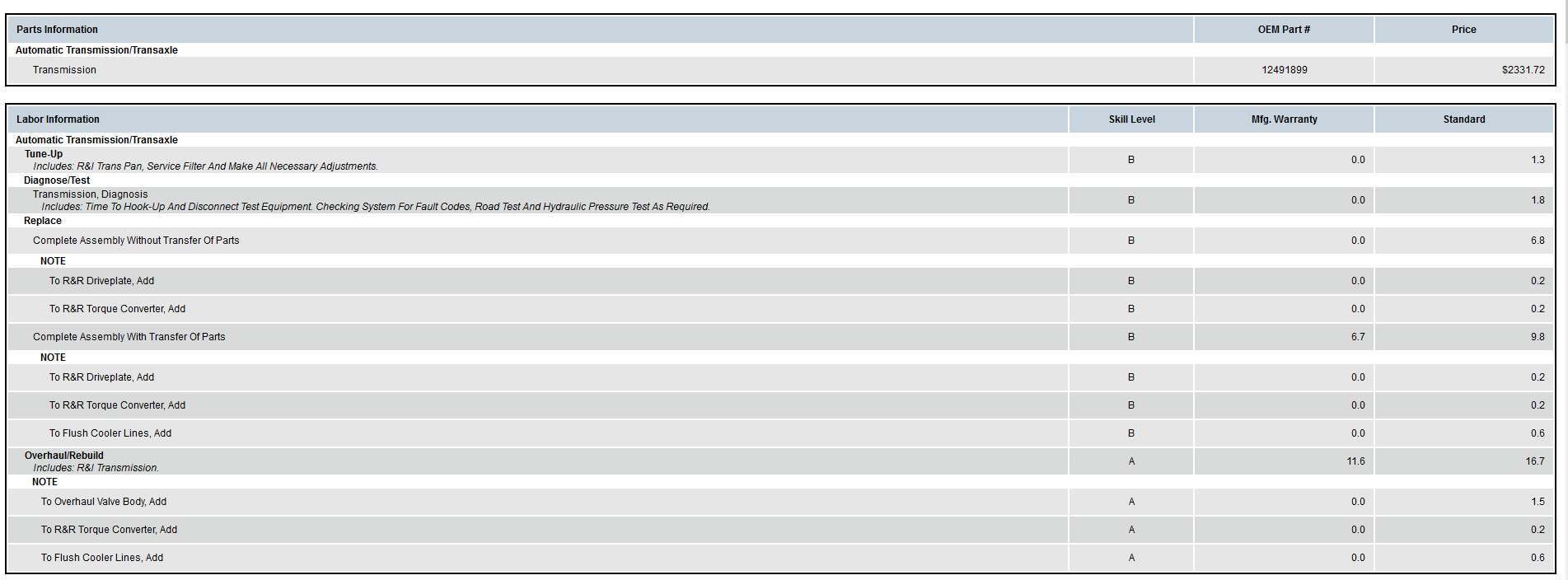

I just looked on my alldatadiy.com account and they don't list the labor hours for the differential, but I could find labor hours for the automatic transaxle (6.8 hrs). The differential shouldn't be much more or less tha the transmission to be honest.
