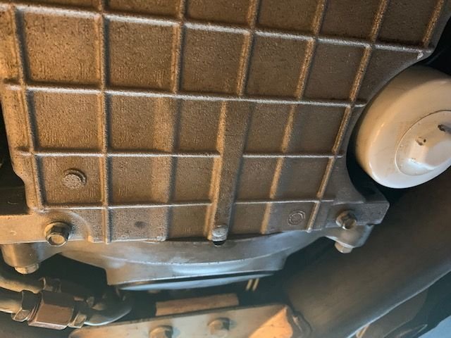

hi the 2 bolts 1 behind the oil filter, and the other directly across in the picture both 10mm.

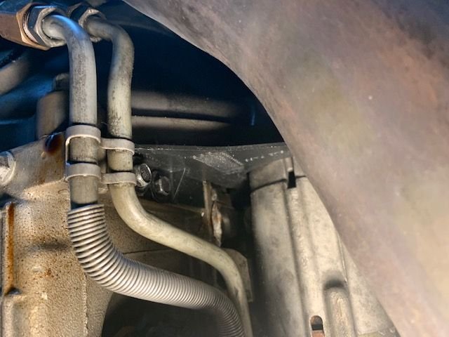

what are these suppose to be torqued to 18lbs? in the second pic I have a drip on the passenger side it starts right above the
pan gasket, there is a 10mm bolt that looks like it goes into the block behind the back of the starter, is it possible to leak from
that bolt? PLEASE NOTE ----this is the single pan-batwing pan 1 piece
thanks in advance.

Those 2 bolts in the 1st picture strip very easy,Be careful,It might be inch pounds on the torque not sure

Not knowing the nomenclature of the bolts in question, here is what I have: Oil pan baffle bolts 106 in lbs, , oil pan cover bolt right and left 106 in lb, oil pan cover bolts 106 in lb, oil pan M8 bolts (pan to engine block) 18 ft lbs, pan M6 bolts (pan to rear cover) 106 in lbs. Hope that helps.
OK I thought it was inch lbs.The 2 bigger bolts are 18ft lbs.

the 2 bolts 10mm that strip easily are 18ft lbs correct? I am referring to the 2 bolts that go straight up from the bottom of the pan
there are 2 that come in from the back that are really big those are 106 in lbs correct.

Can't help you there. I don't have a service manual so I don't know which bolt is which. Logic would seem to dictate that the bigger bolts have a higher torque but that may not be the case. I will see what I can find out.
Found this. Hope it helps. https://www.corvetteforum.com/forums...ng-torque.html
