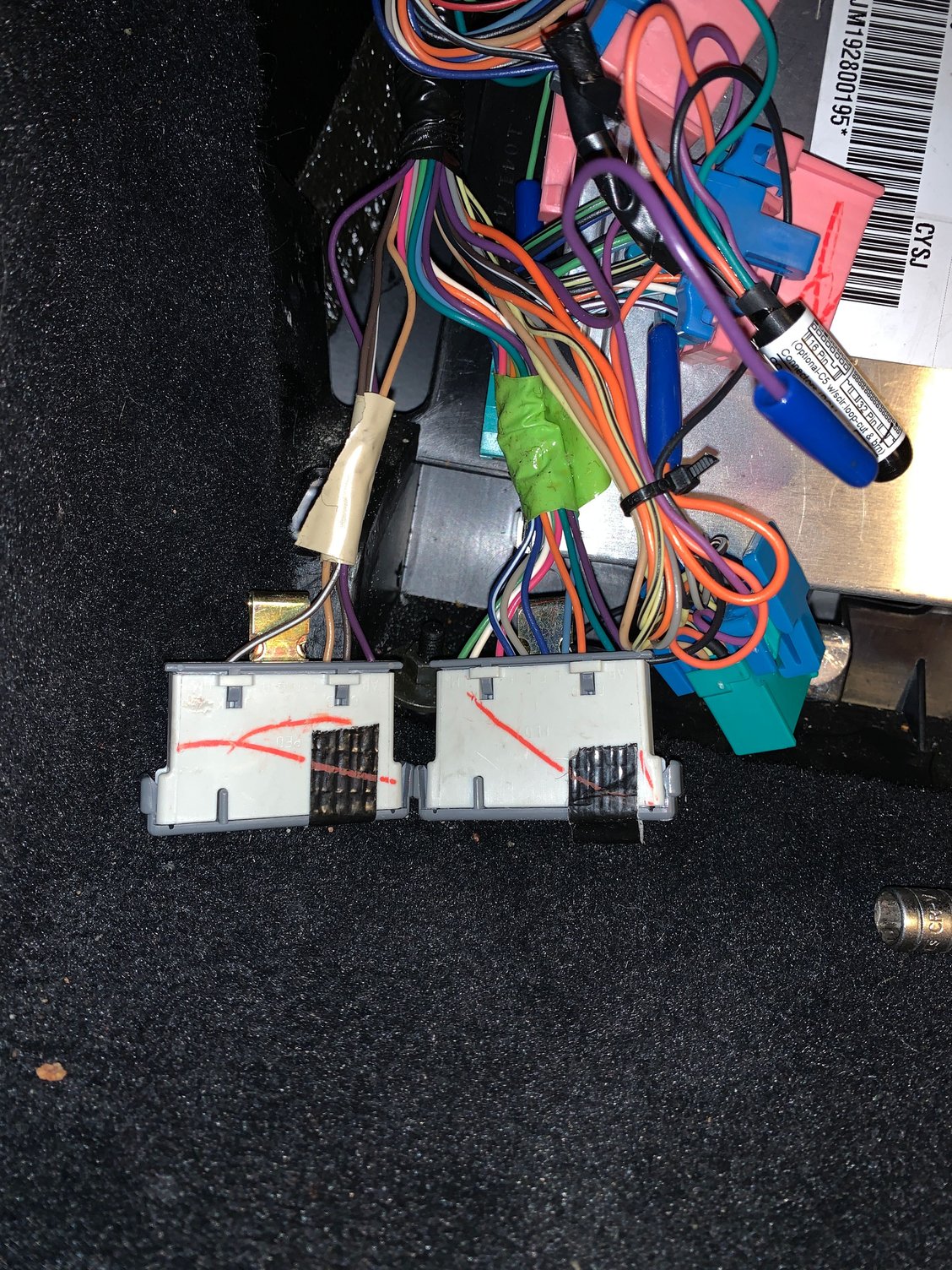

If you don´t see the odometer your serial databus is maybe corrupted (shorted) or you have a ignition switch problem causing to low voltage to the electronic modules .
First you can try to disconnect one of the star ( the starconnector with four wires only) connectors located in passenger footwell .
Check if this make any difference .
( Your windows/seat control will no work but maybe your odometer will show up and reduced engine power will disappear )
