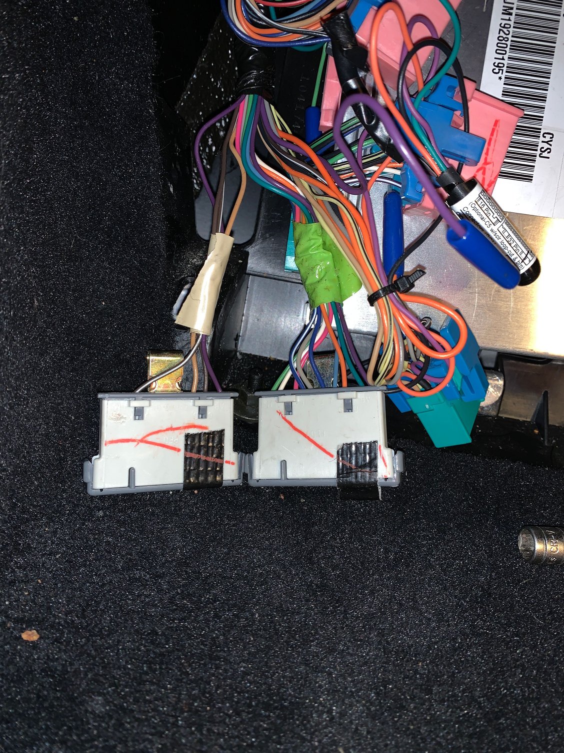

Are you able to see any trouble codes in the DIC in the cluster ?
If not you may have a corrupted/shorted serial line and you can try to remove the star connector to the seat/door modules
in order o locate if these problems are causing any of these issues .
These connectors are located on the left side of the body control module in the passenger footwell .
Remove ONLY the connector with four wires.

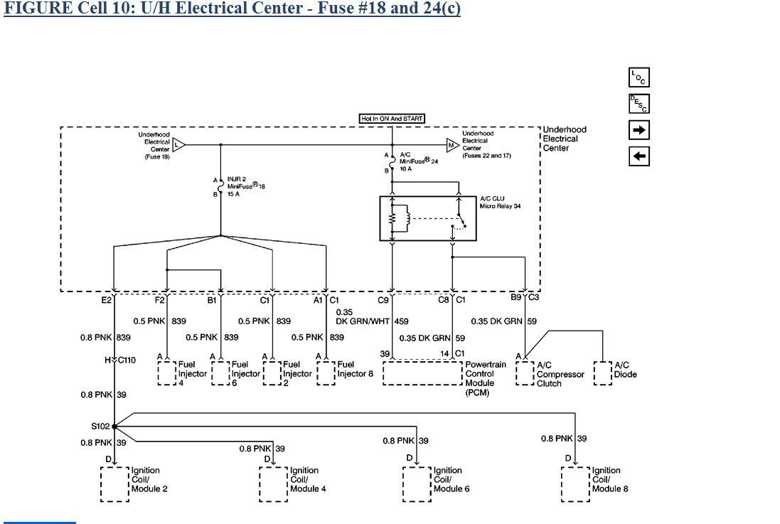

Also a Reduced Engine Power mode is normally set if you have error within the TAC system (TAC module, Accelerator Pedal Position Sensor or Throttle Position Sensor ) .
But this will normally set one or more DTC's on your Digital Information Center .
Also if you have ignition switch with defective contactsets due to long time wear you can have similar symptoms .
If you measure the voltage between battery positive terminal and Minifuse 18 ( point A or B) shown on the schematic below you shall not measure more then 0.1-0.2 volt
If the contactset of the ignition switch is burned due to "high current wear " over 30 years these contact sets can cause several volts drop over the contact sets .
This will result in too low voltage to the electronics supplied by the voltage from the igntionswitch and strange things start to happen .
If you measure this voltage with engine running and some current load to system(Lights/AC on) , this will show the voltag drop over the ignition switch better ( if the ignitionswitch is your problem).
Voltage drop equals to resistance x current (ohm's law)
Do these checks and report back .
If the problem is a faulty ignitionswitch these will cost only approx .USD 70 in parts
