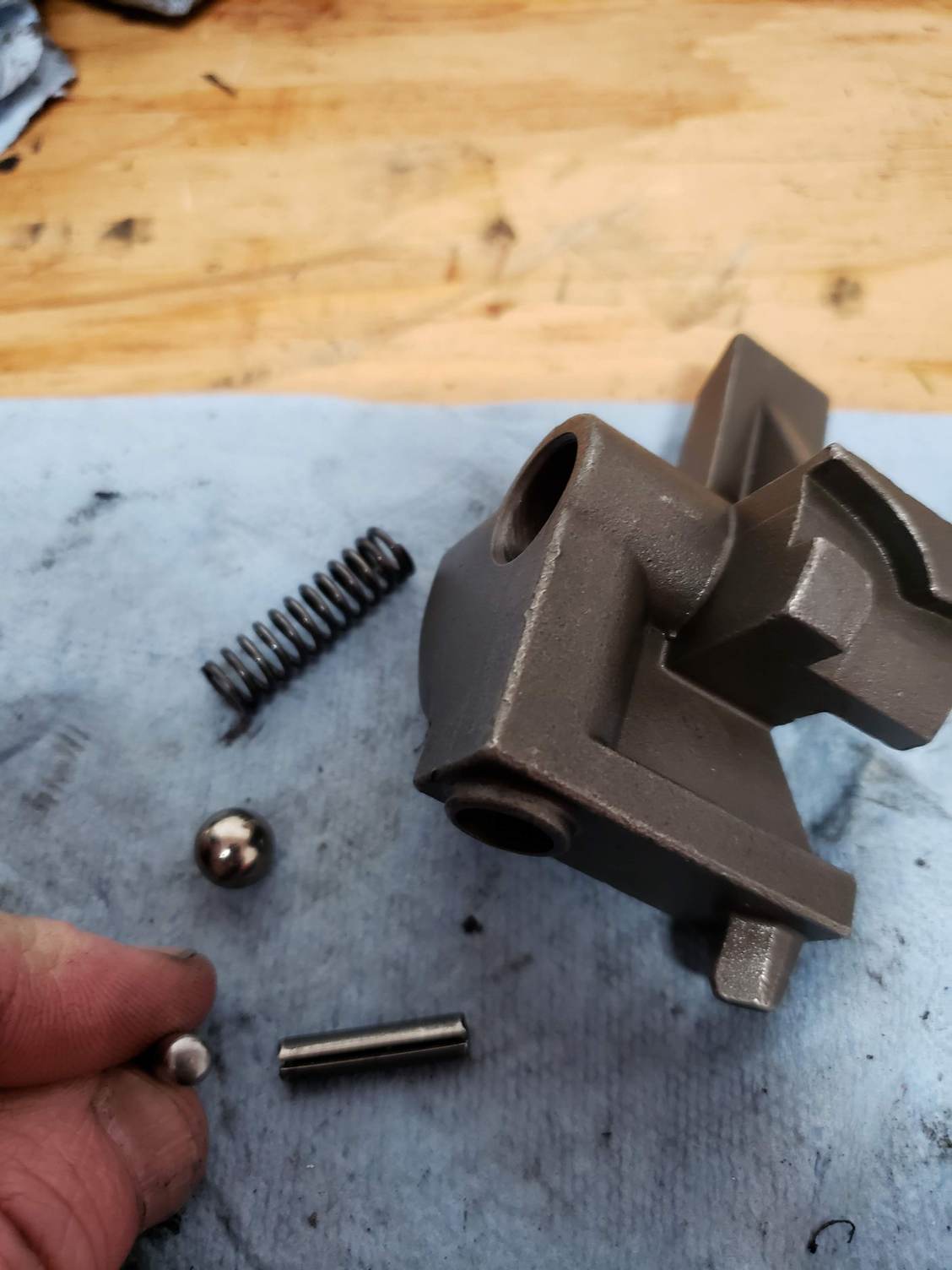

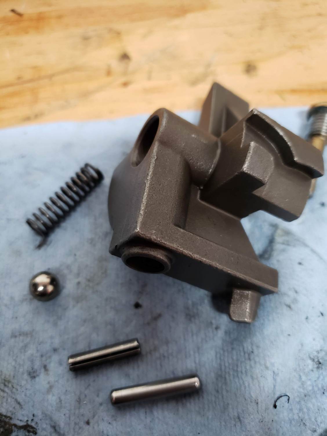

It's solid, it's an inch long, and I am not sure where it came from. I'm buttoning up my transmission tomorrow and I'd like to know for sure where this came from before I do so as I'm not a fan of having extra parts left over. .

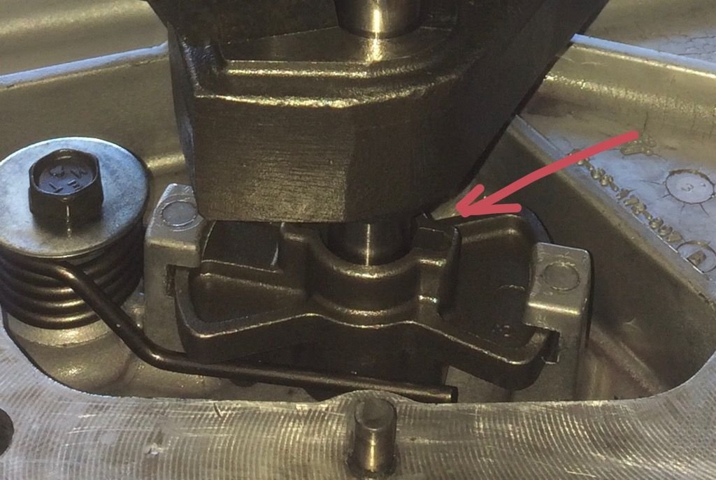

I’m not totally sure, it has been long time ago... I think this might be the area where the pin goes.

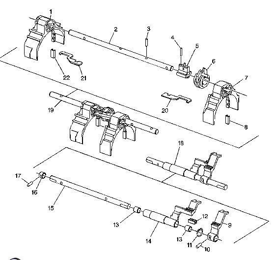

Pins: #3,4,10,17
Also case front/rear extension alignment pin.
I think that's exactly what it is. Thank you so much!
