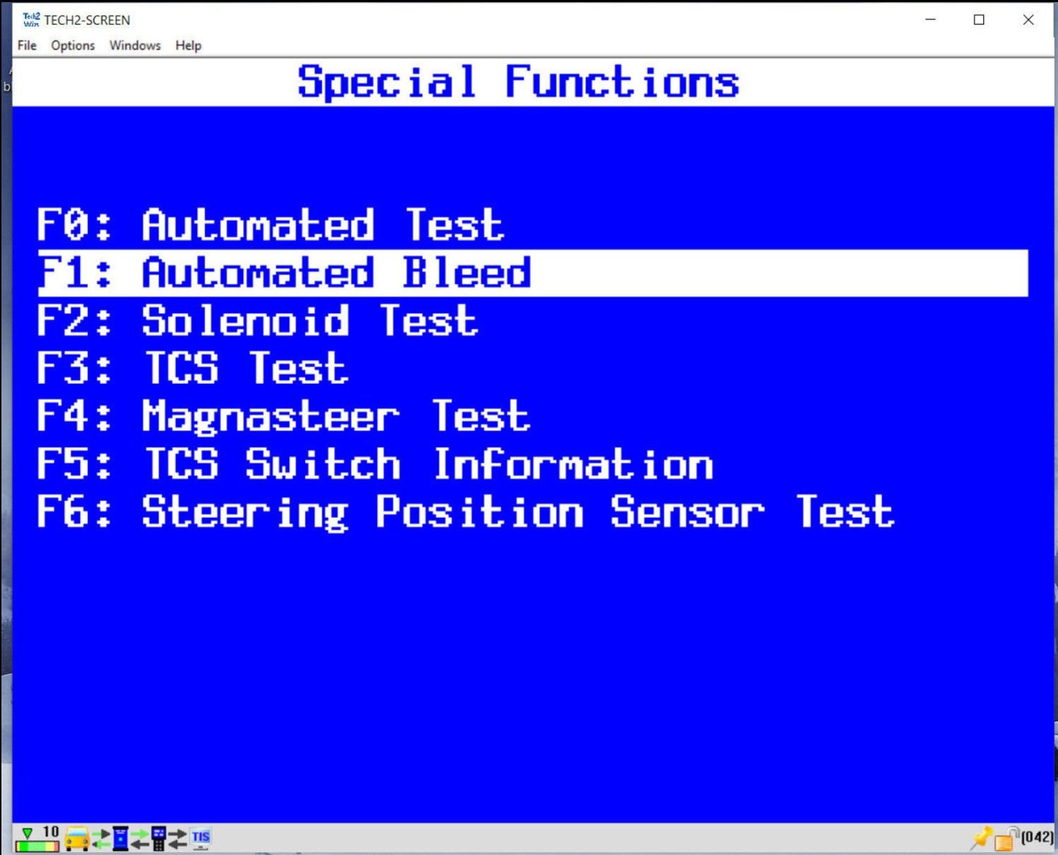

I perform a Automated bleed with my Tech 2 when I replace my brake fluid .The Tech2 command pump on and open different solonidvalves during the Automated Test
The pump are running about 30sec on each wheel when I bleed the brakefluid from all wheels .

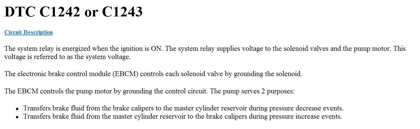

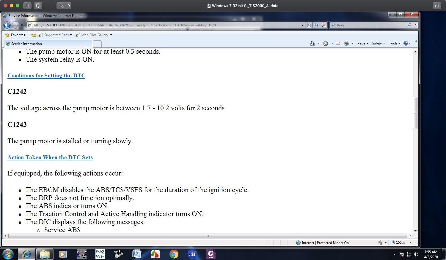

The C1242 appear when the system voltage for solonoids and pump is getting too low .
This could be caused by several things .
Blown fuse , bad continuity on grounding points ( have you checked these ? )
Also the EBCTM relay is known to go bad . If nothing else works out you can try to replace this relay shown below.
If your ABS got stuck and the pump currentdraw got too high due too high friction in the pump you should have the DTC C1243 as far as I can understand the function of the DTC´s

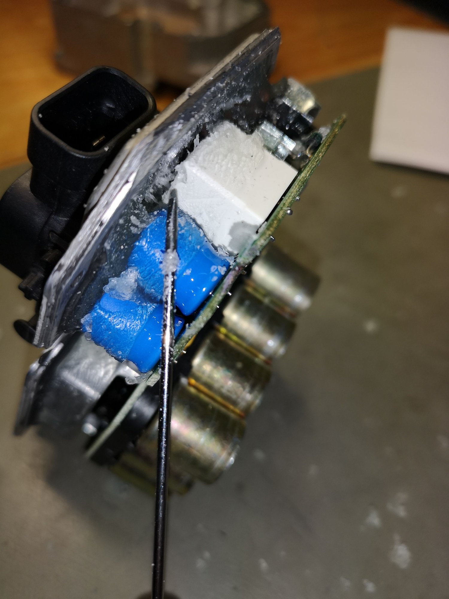

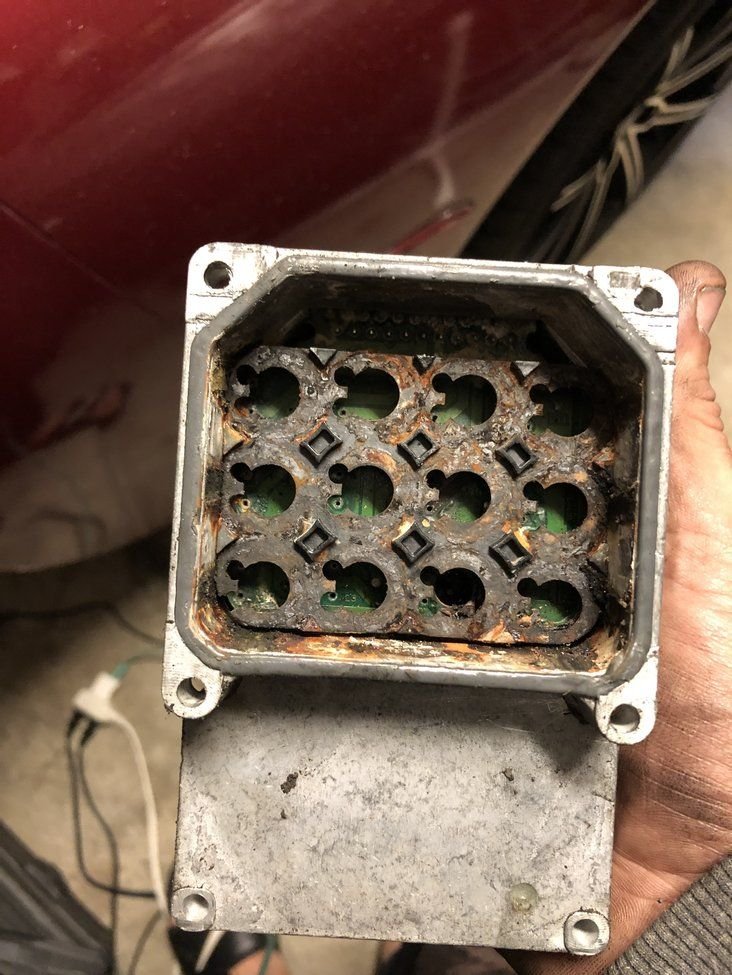

A good advice is to verify the function of the ebctm and relay before you put on proper seal
if if not you may end up like this after some time
I replaced this relay on my friends car (02 mod) with this relay

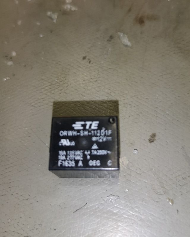

The relay my friend bought for his car , ORWH-SH-112D1F ,( 10A single pole relay ) and I replaced in his EBCTM
should be available from several places .
Here is a place in Canada and also on ebay
If you search with Google you should be able find a store within US with this relay on stock ( I live i Norway so I am not familiar these stores inside US )
