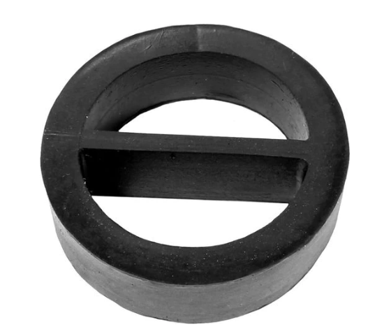

that is why i used exhaust rubber, meant for high temp. i think i took a torch or heat gun to it first to see if it would melt, and it didnt
you could get something like this, try the same thing with the torch or heat gun, then cut a section out making i like a C

throw a piece of high temp rubber up there, if you get the strip with holes, you put some wire through the holes to keep it attached to the piping

Old Apr 6, 2020 | 07:43 PM
Travlee's Avatar
Travlee
Posts: 16,005
Likes: 2,689
From: Frisco, TX
I cut the metal part off
https://www.oreillyauto.com/detail/b...r+rubber&pos=8

awesome idea. Thanks
