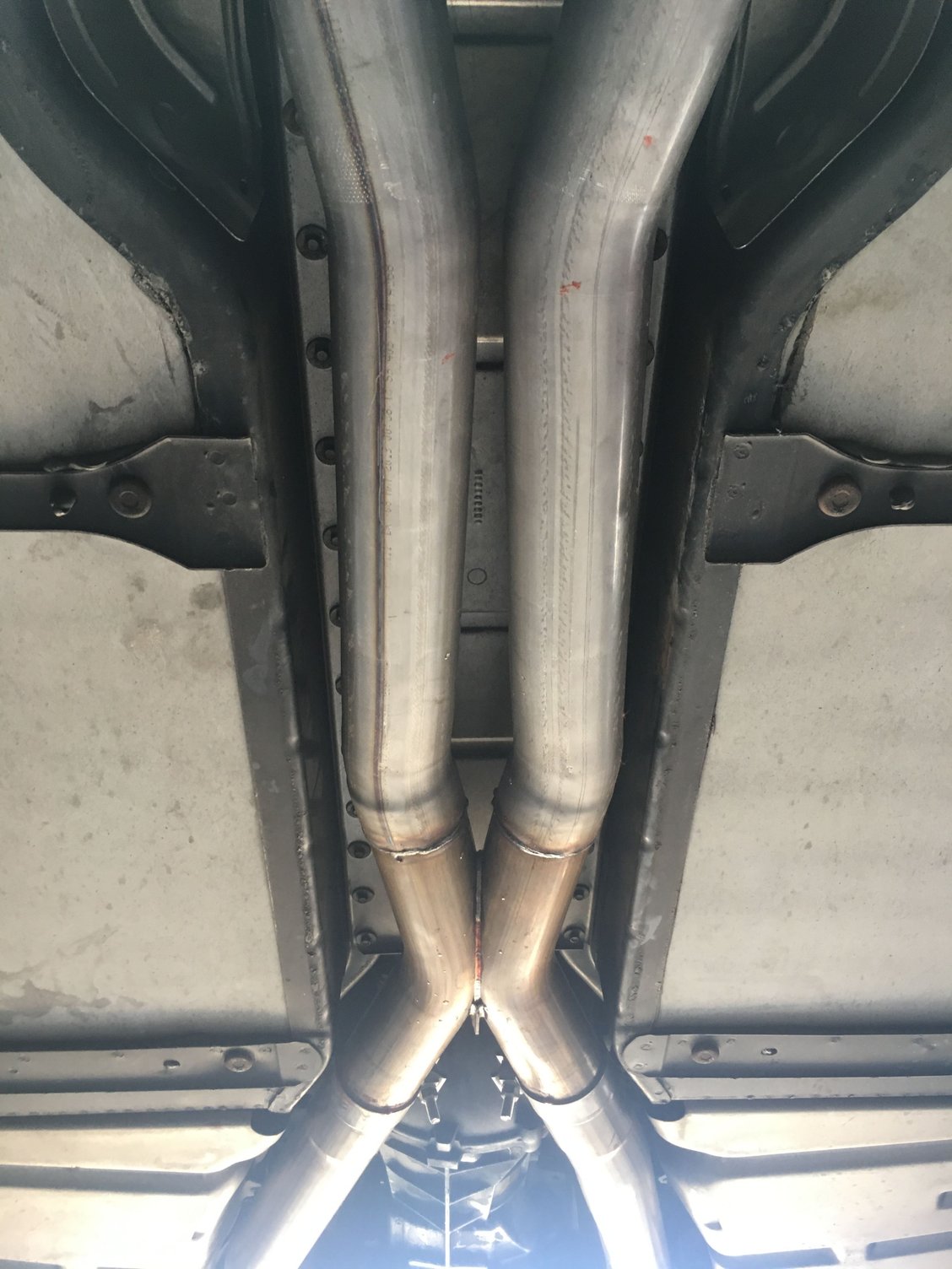

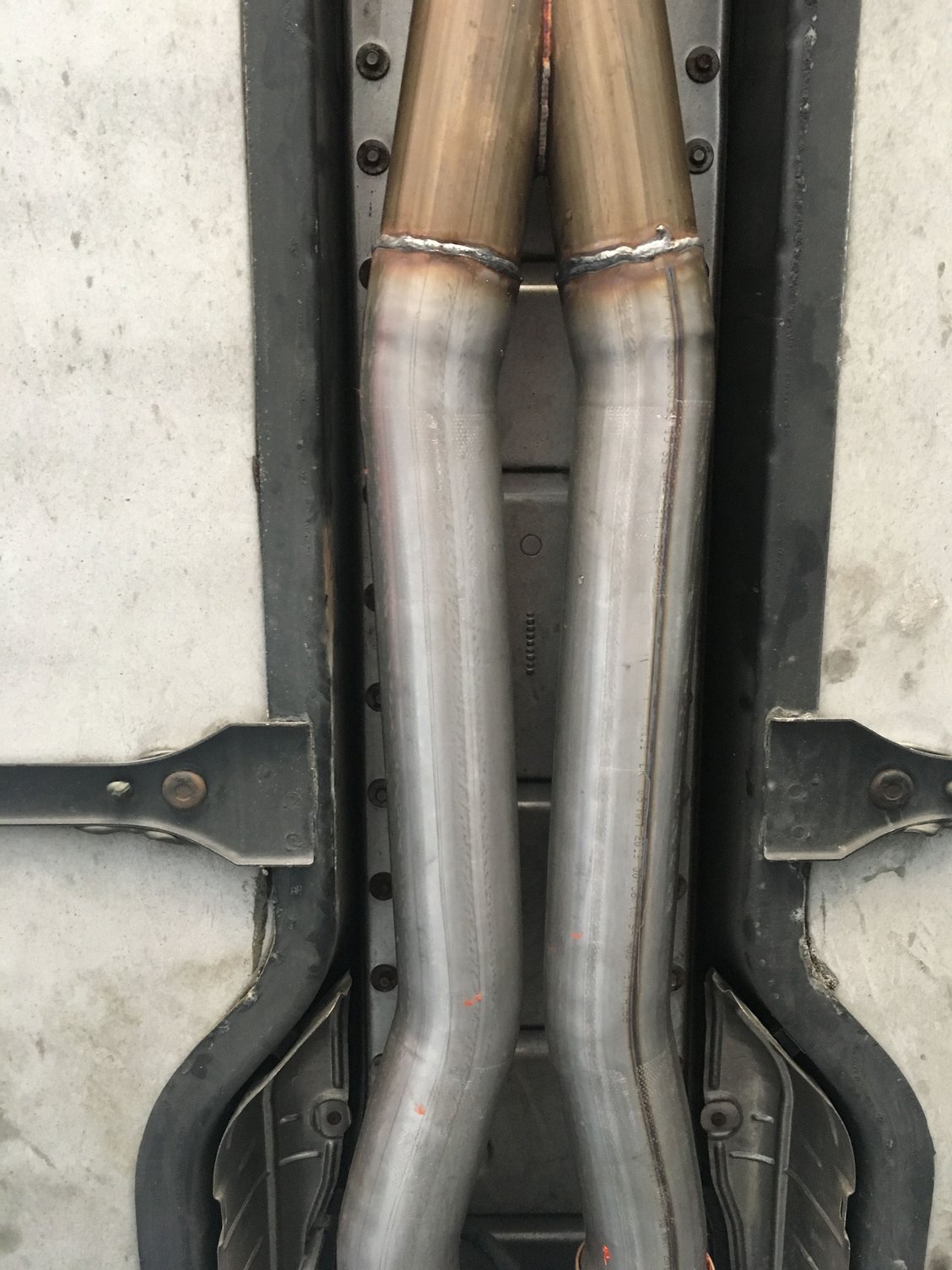

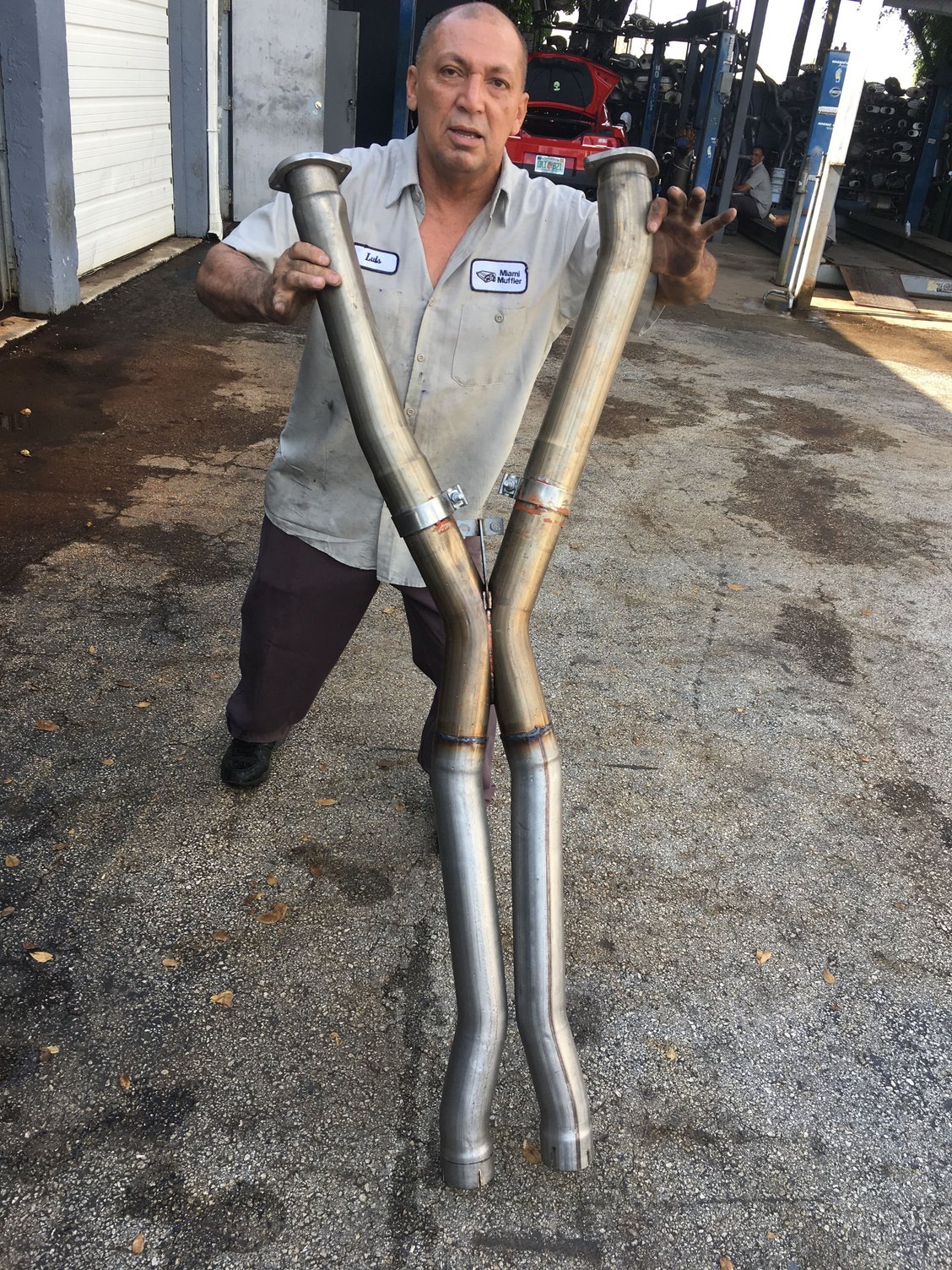

Man I should’ve fixed this a long time ago. Problem solved. Super quiet cabin finally. I don’t even here the LS sewing machine valvetrain noises anymore. Muffler shop had to cut the segment that had interference and just welded a new piece. They custom fabbed the segment, bending it a bit at a time until perfect. Midpipes run much closer together on the center of the tunnel.
