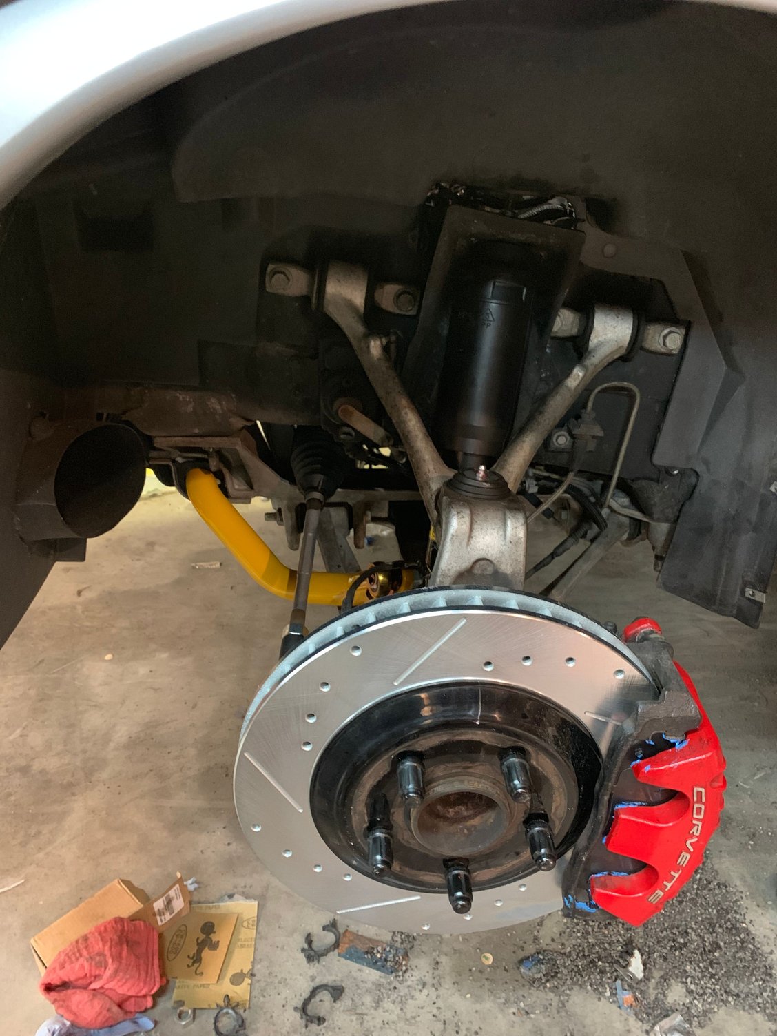

OK forum members I need some help,
I had a warped rotor on my 98 vert. I decided just to replace all four rotors and brake pads. I went with the AC Delco professional line rotors and semi metallic pads. Everything went together great with no issues. I’m not a mechanic but I’ve been doing my own brakes for ever. The pulsation was gone and the car stopped great. I called AC Delco to see if they recommended any sort of break in for the new pads and rotors and they said “just drive the car normal…no special break-in”. Like I said everything worked great but then I just started to develop a squeak at low speed braking. It doesn’t seem to change in pitch or severity just constant consistent at the lower speeds.
I pulled all the brakes apart cleaned everything put it all back together double checked all the torque specs. The squeal went away for a little while but then returned. The car stops great and I don’t feel any pulsations or issues other than the noise.
Any ideas?

back of the pads where the pistons would have contact, the corners/notches where the pads slide into the brackets (inside of the hardware and outside) and then lube the float pins.
Not sure this shows it but all I had its the blue goo

*update* I pulled EVERYTHING apart…cleaned every bought a “ultra”brake lube…lubed everything…changed sides on the pads so the wear indicators are in the “upright/inside” position. Torqued everything To spec…took it for a short drive and (fingers crossed &#129310 no squeak!

******UPDATE*******
ok so I pulled EVERYTHING apart cleaned EVERYTHING and lubed EVERYTHING. have not put a ton of miles on her since but so far NO NOISE!!!!
thanks for all the help and info!!!
