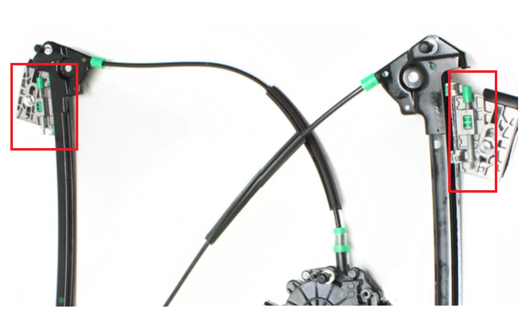

It's not that bad, just a learning curve like most things working on something the first time. The moisture guard broke on mine, so had to replace. Did both sides. 4mm socket wrench and 6 series female torx is important to have.
Biggest thing I wish people had told me was height adjustment. Never found anything like what I'm about to post, but these are the window stops. If they are too high up, the window will create wind noise at the seals.
If theyre too far down, the window will hit the blow-out clip at the top of the door. I recommend AC Delco brand after using a cheaper brand.

looking like that’s what I’m gonna have to do, thanks for the pics, should help a lot.
