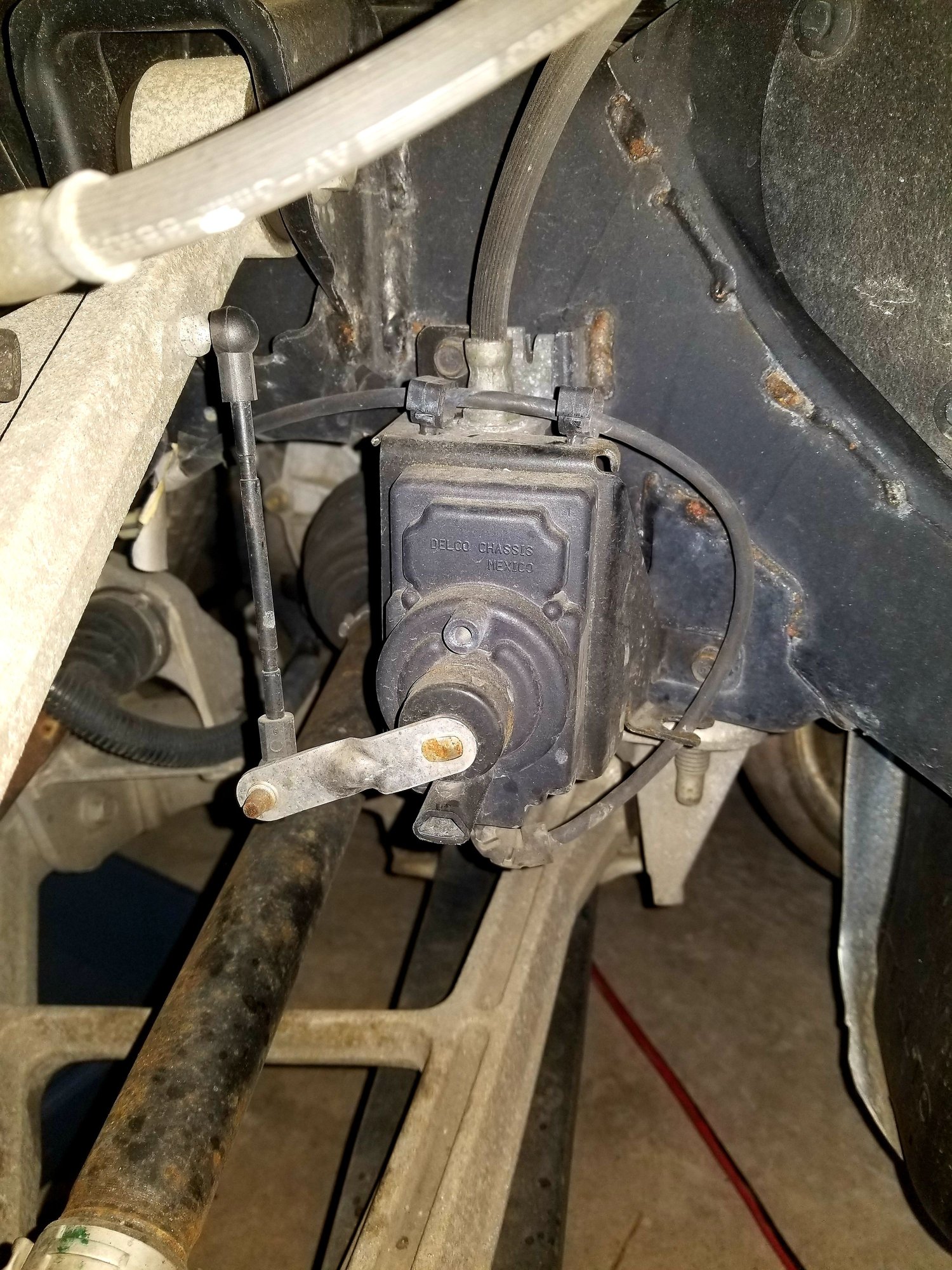

I want to change the flexible brake lines. But the F55 shock sensor is in the way. I see 2 screws that need to come out. But I was worried about the lever that's connected to the lower control arm. I don't want to break it. Or is there a way I can take out the spring clip from the side? Not much room there

The rod pops off. When you put it back on use some lubricant.
